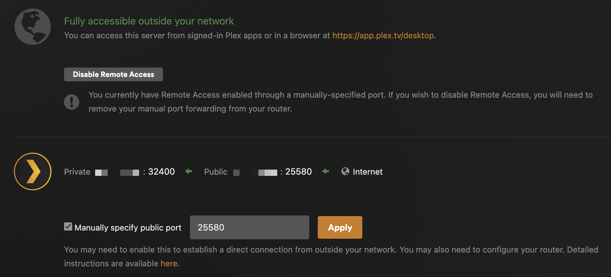

A media server simply gives you more options for all of your media content. The following are just a few advantages if using Plex:
Prefer to securely host your media on a remote (cloud) instance instead of your home?
