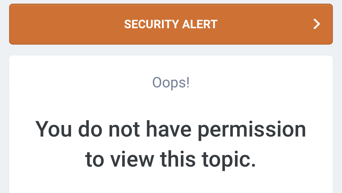

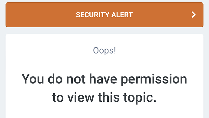

@james The Emby devs have posted their thoughts on this:
https://emby.media/community/index.php?/topic/119273-unable-to-log-in-to-the-apple-systems-fuse-indicating-incorrect-user/&do=findComment&comment=1259354
Blast my lack of a top-secret security clearance.
This is the content of the post on the Emby community forums:
The infuse client side code is trying to use an api that is now only allowed for admin users, which is getting the list of installed plugins on the server.
What the client code should do instead is remove the check, just assume that the plug-in is there, and be able to handle the 404 responses it will receive if it is not.
