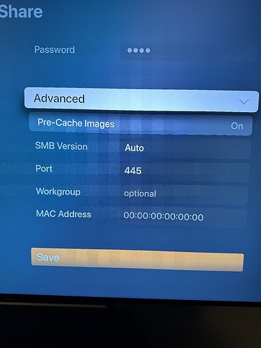

Here are the Infuse settings on my Apple TV:
These are the Infuse Advanced settings. Should I do anything here? Maybe change the port???
Not sure if any of this is helpful… Thanks again for your advice. :slight_smile:

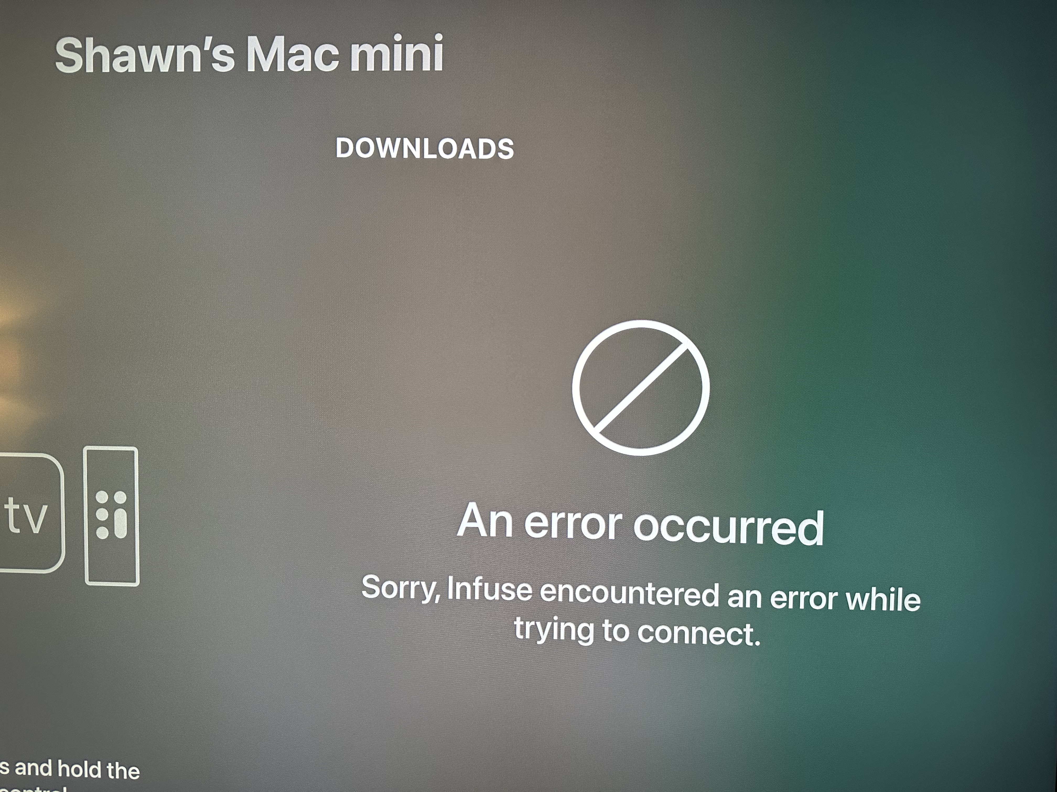

However, when I tried to open the folder in Infuse, I got the message…
That’s farther than I got with a Username and Password… but still not working. :frowning:
