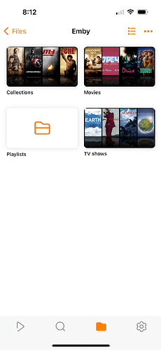

Yes I’ve definitely done this already but playlists just don’t show on my Apple TV in Infuse even though I’ve told Infuse to show playlists.
If you are using Direct Mode, Playlists will not show in the Library > Playlists area.
These will be visible if you navigate to the Emby share from the home screen and select the Playlists icon.
