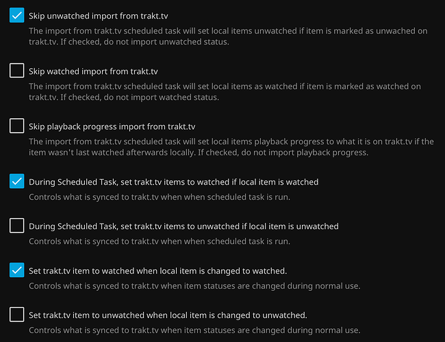

If turning off Export Media info doesn’t help can you give me a screenshot of the various options in Jellyfin with the Trakt plug-in.
I haven’t used Emby or Jellyfin for ages but I do seem to recall that Jellyfin had quite a few more options than Emby.
These are it:
Turning “export media info" off seems to have made no difference. It took ~1h for the plugin to run through the sync :exploding_head:
Ok from what I remember those settings look reasonable.

If I enable stop watched import and progress from Trakt, the plug-in runs under a minute and all is done. So either that or a once a day update at an hour when nobody is streaming is the solution.
