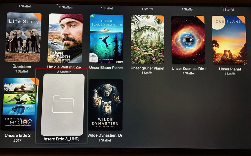

Some titles in Infuse don’t get a poster and also the name in Infuse is the name from the folder (on my NAS).
Here is an example of the show "Unsere Erde 3", which is shown in Infuse with the folder name “Unser Erde 3_UHD_HDR” (“_UHD_HDR” are tags that I add to the foldername):

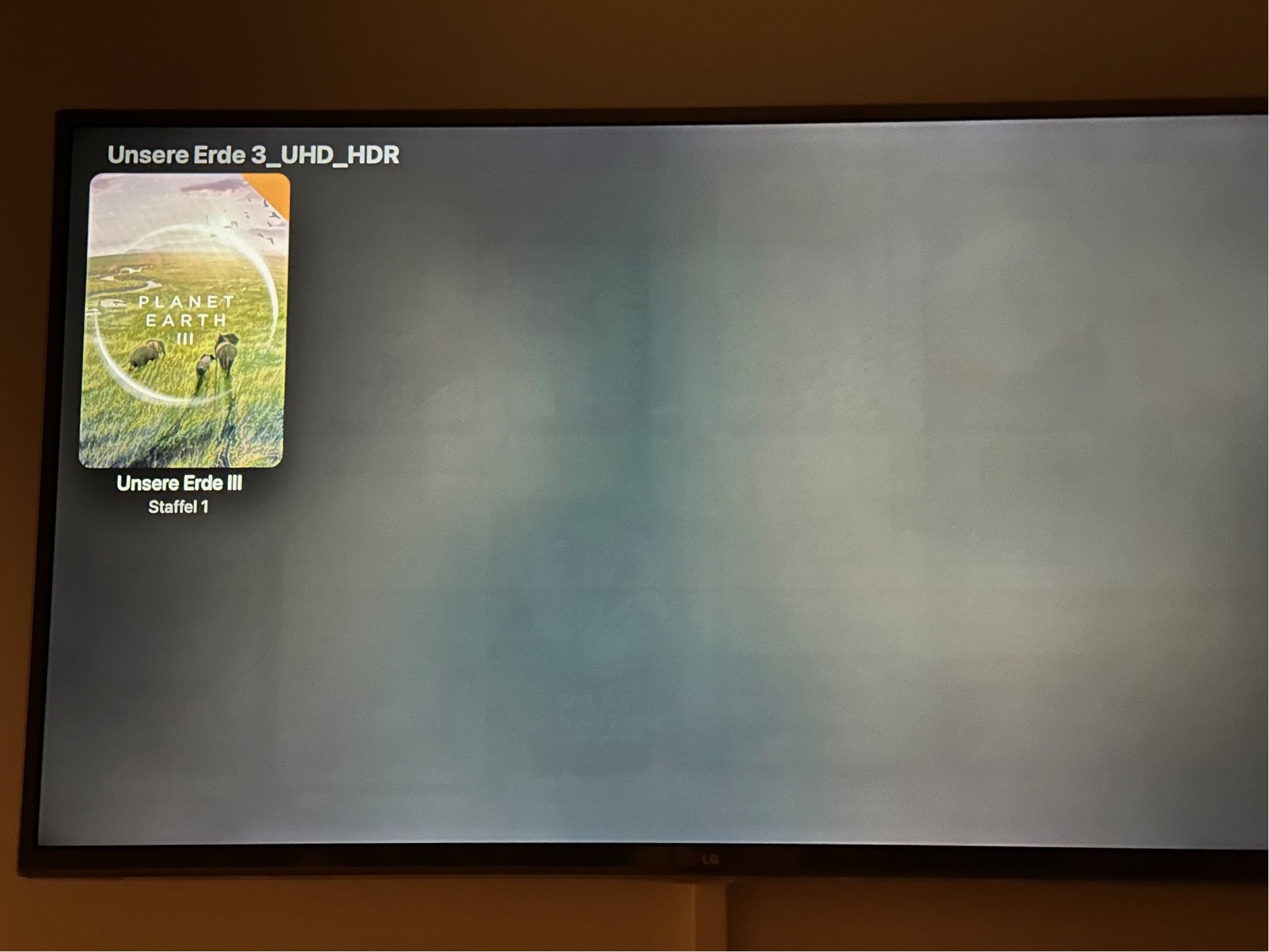

Now interesting is when I go into this folder (in Infuse) the season itself does have a poster and metadata is correct and all:

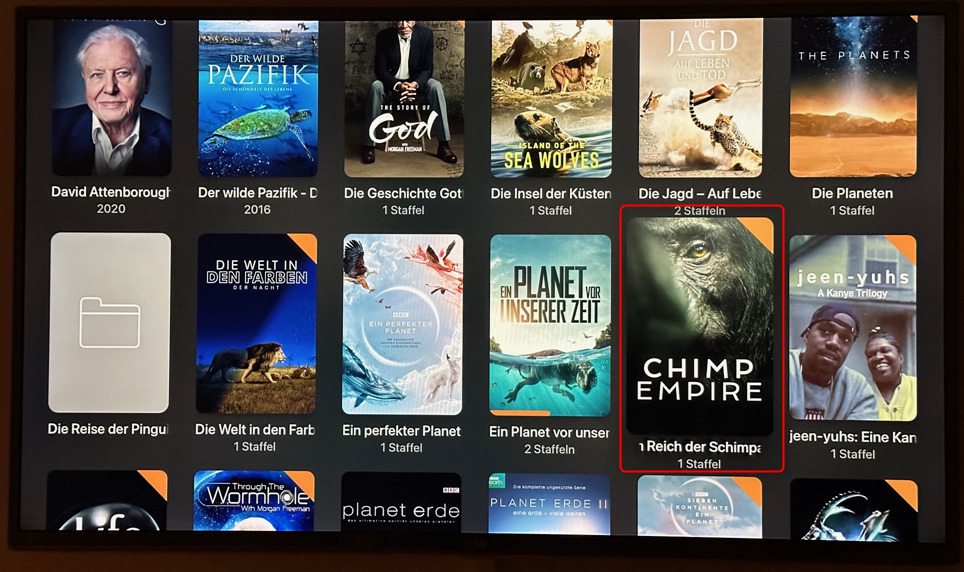

Now I have another show, which is similar, but in this case the folder (in Infuse) does also have a poster:
The name of this folder (in Infuse) is not exactly like the foldername on my NAS, instead the real show name is being shown (like it should be).

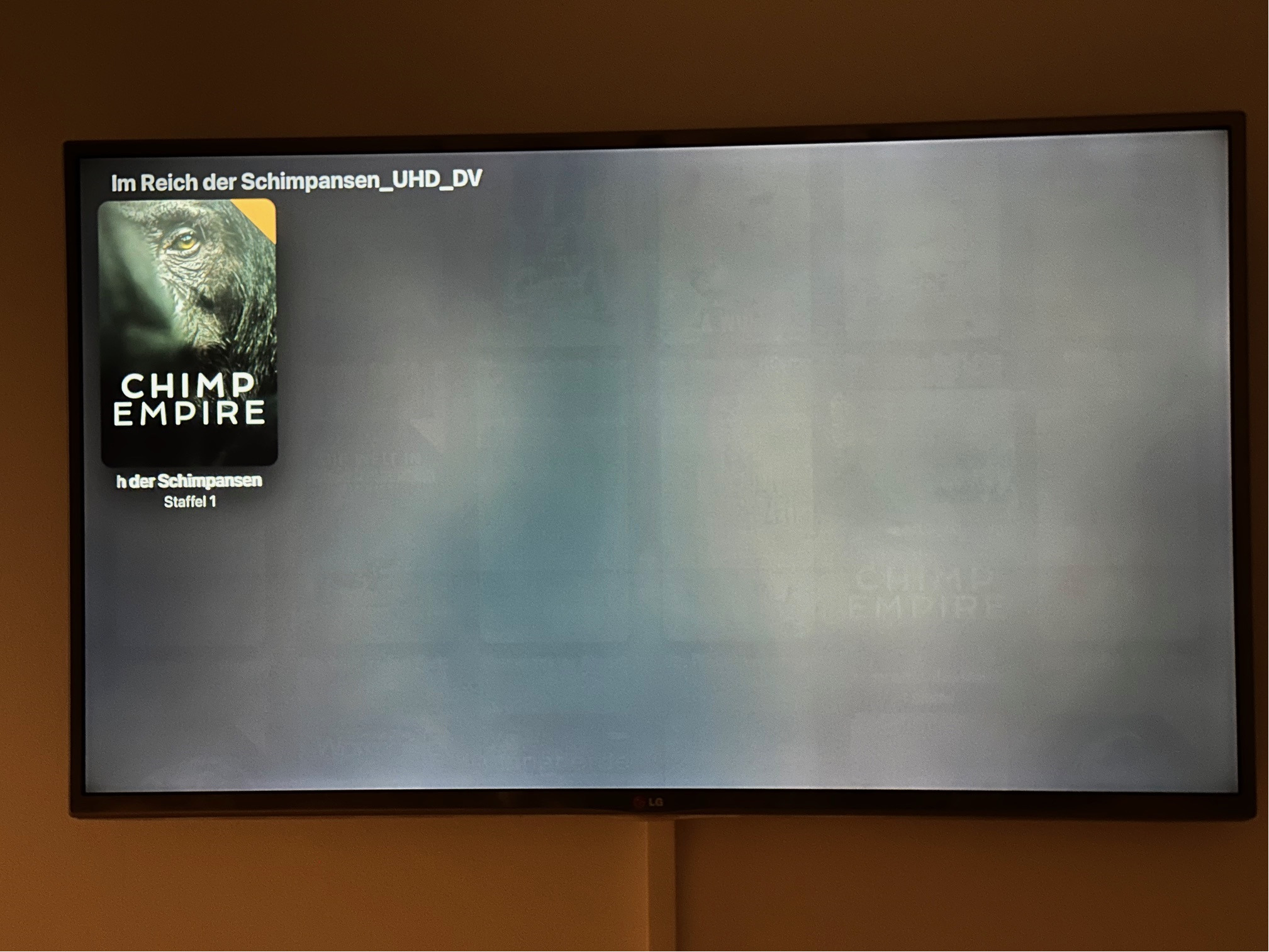

Also when I go into this folder (in Infuse) the season is also correctly shown:

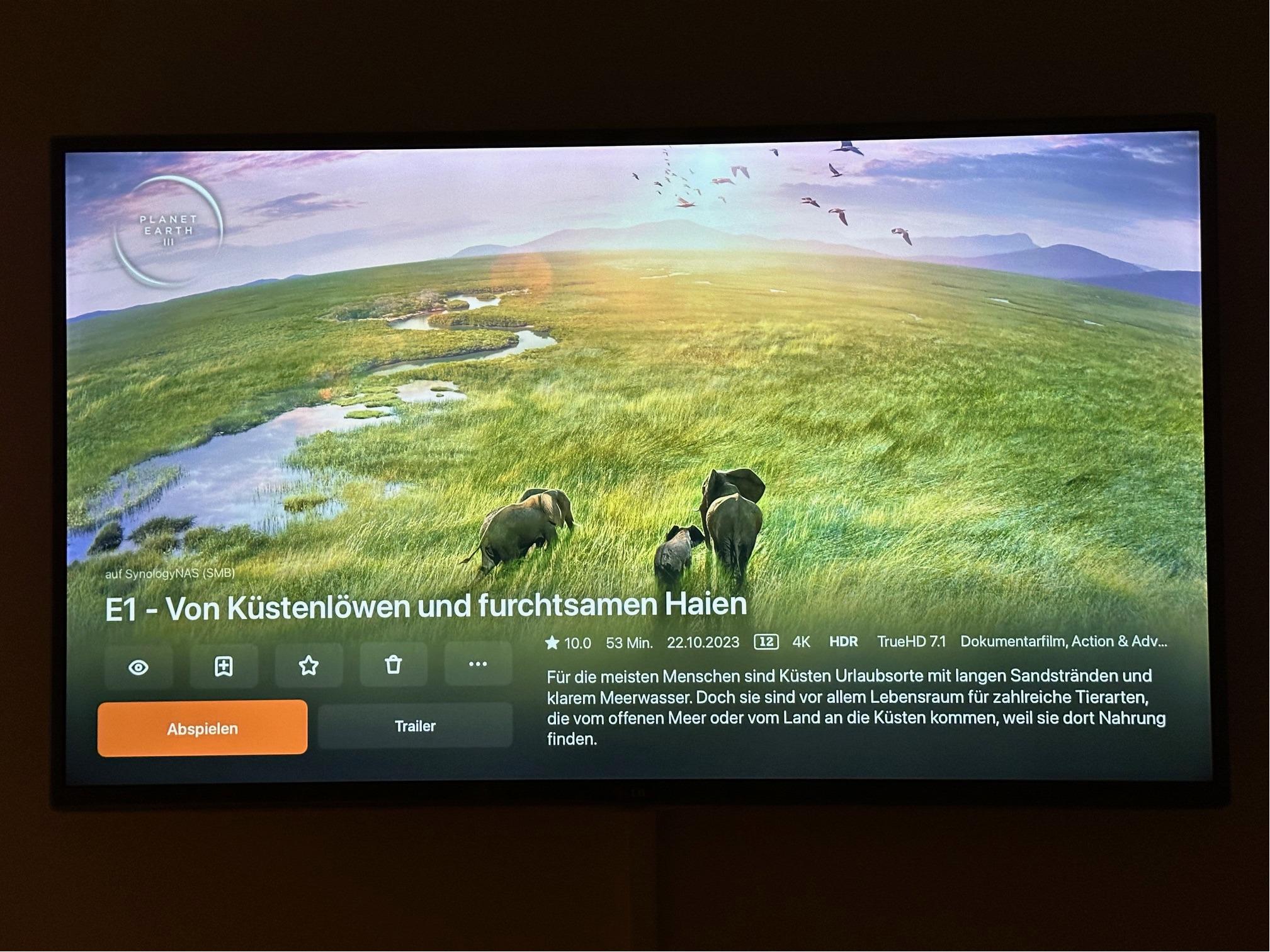

Also also the Episodes are shown correctly with all metadata:

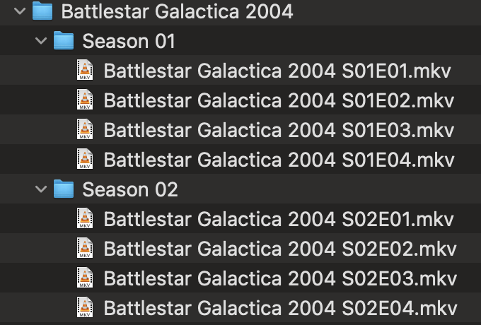

If you standardize how you name your folders and files as follows you shouldn’t have any more problems.
First, the TV series folder needs to be just the series name (and maybe year). Inside of that you need individual season folders (even for only 1 season shows). Then the file name needs to match the rest. Often, having the year follow the series name and before the “S0xE0x” id will make it all work with the least amount of problems.
File name and folder structure example
