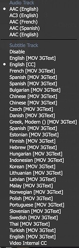

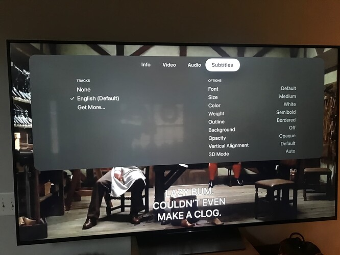

In Infuse, what do you see under the “Audio” pull down menu?
I’ll start it up and get back with the info in a short while

because I can, tried TK Player … subtitles work fine. Screenshot of the audio/subtitle list

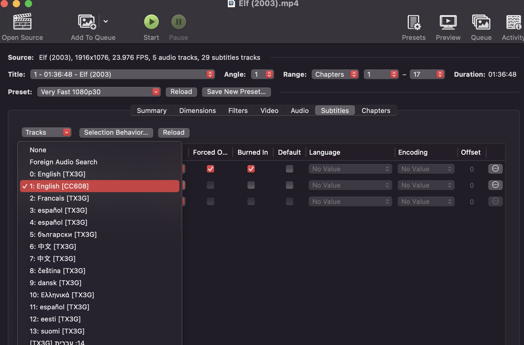

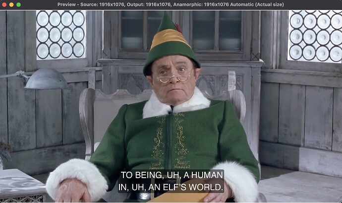

Handbrake can select the subtitle track

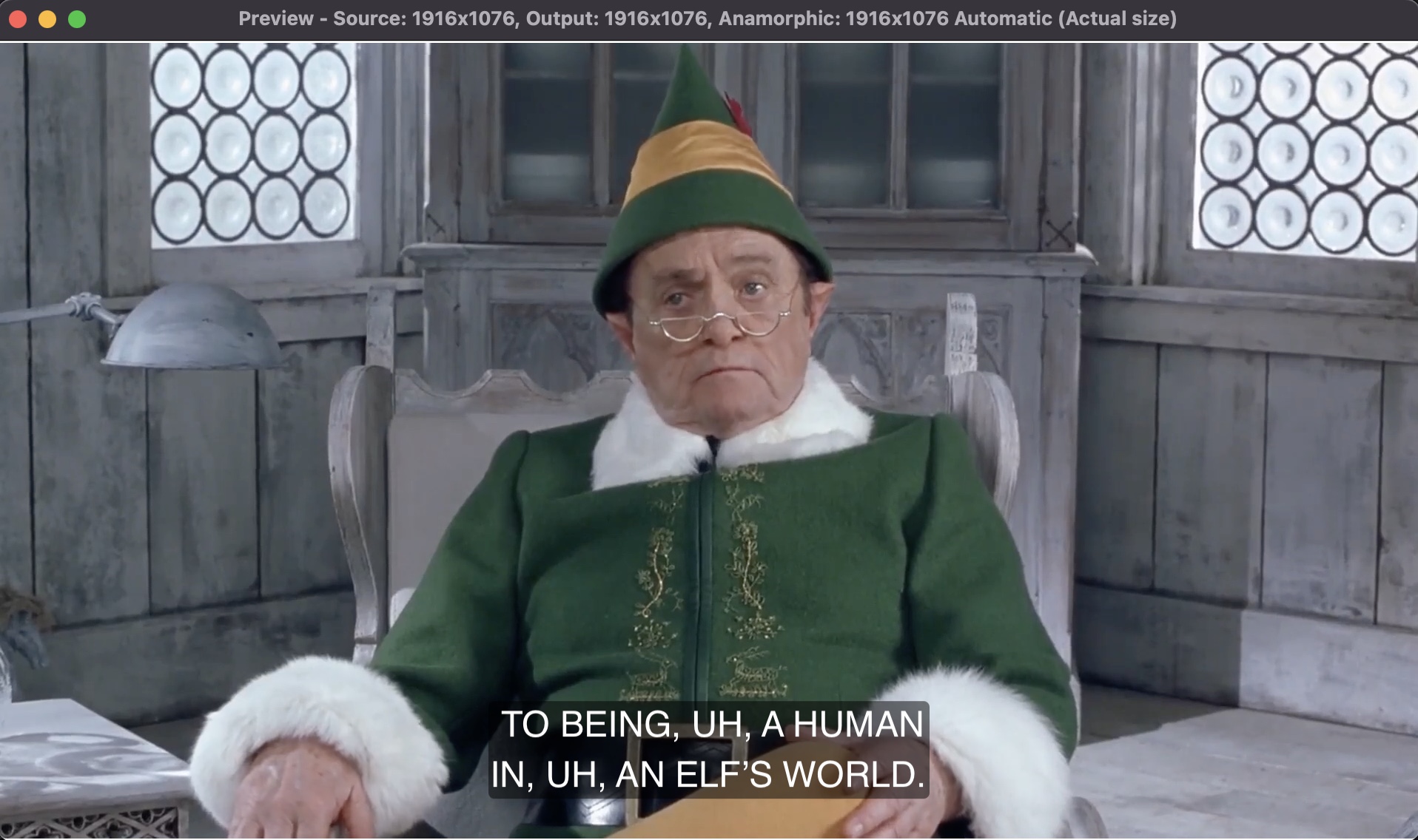

and then a Preview displayed the subtitles
I added the Handbrake file to the Infuse library and shazam … the subtitles are there.
While this is good, there is no way to run 100’s of movies through Handbrake to get Infuse to recognize the subtitle track.
Quicktime and Handbrake both have no problems with subtitles. To me, this is a problem with Infuse.
