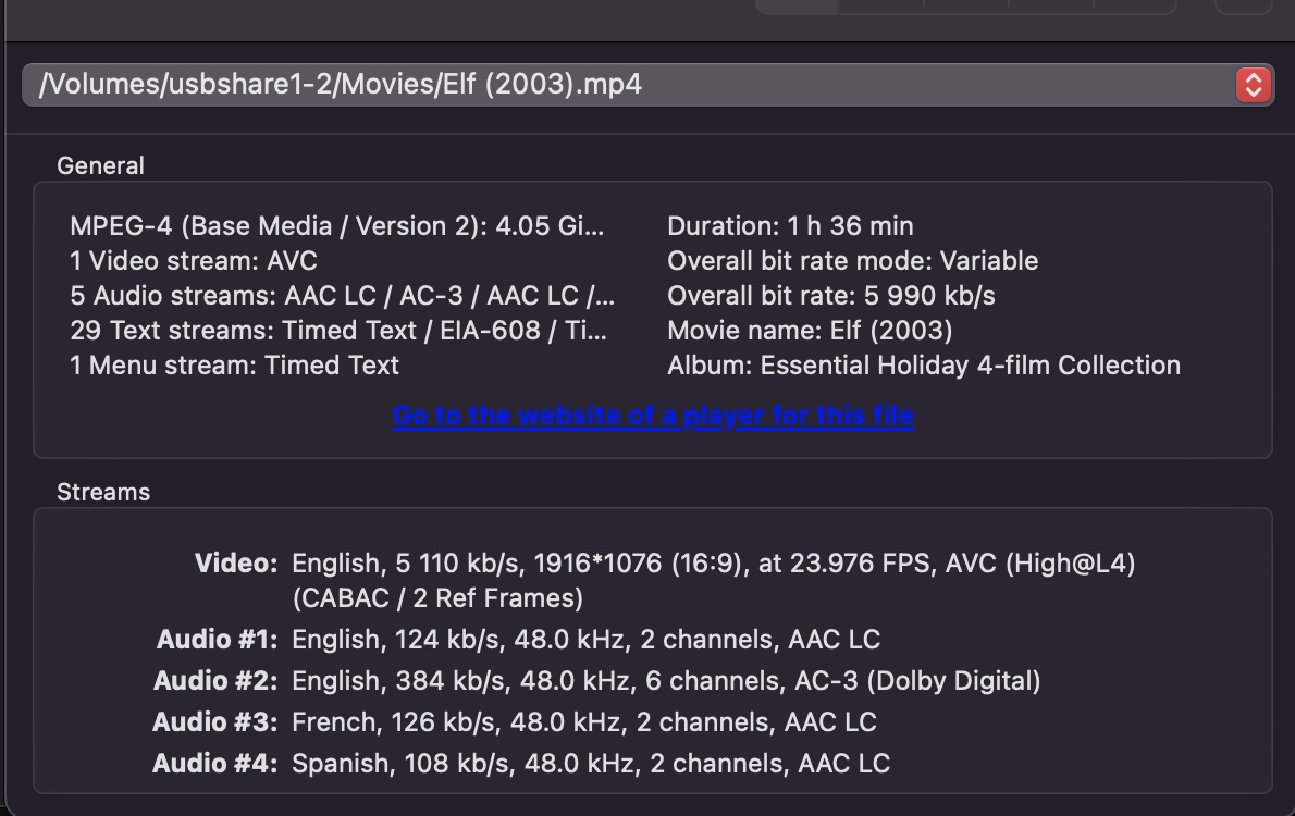

Can you run this video through mediainfo and post the results here?
Also what device and what version of Infuse.
MediaInfo.txt (32.6 KB)

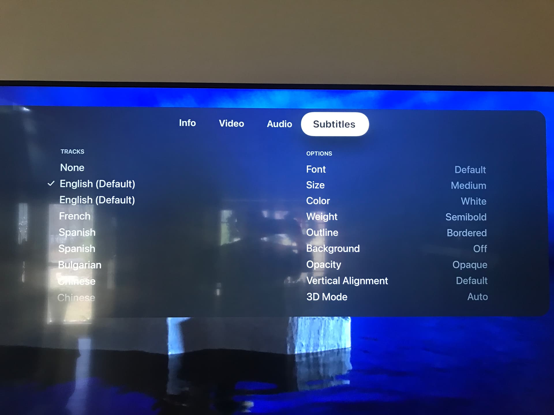

INFUSE 7 installed n an Apple TV 4K

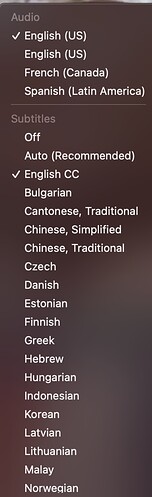

screen shot using quicktime with subtitles
Are you using the pull down menu when playing the video in Infuse and selecting a subtitle file?
INFUSE 7.2.1 … yes swipe down subtitles
And no subtitles appear with this check? What about if you select the second “English” still not working?

I’ve tried both english items, nothing … selected a few other languages and some of them show.
Via QUICKTIME, they all seem to work just fine.

in the subtitle screen shot … starting with the 2nd Spanish, the subtitles seem to play . Tried quite a few but not all .
If you scroll down through the different languages in the subtitles is there another “English” at the very bottom of the list and if so, does it play?
There was another English last just before “Get more”. Selected that one and subtitles appeared in something other than English. Chinese possibly
Gotta be a bug … Quicktime has no issues without the subtitles. Infuse on the iPhone, on the Apple TV have problems with the subtitles which mostly seem to be English defaulted.

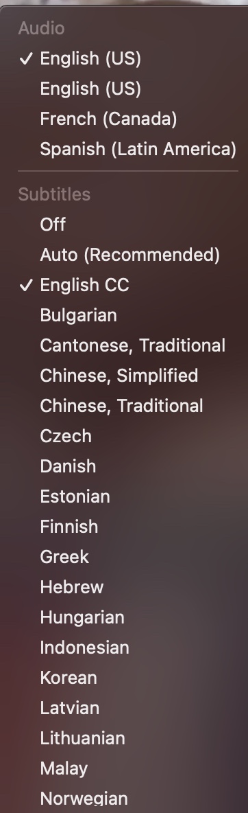

Do you see the same number of and order of subtitles available in quicktime as you do in Infuse?
Screen shot … appears to be the same list, same order.
wait a second … the INFUSE list appears to be the Audio/Subtitle combined, mashed together. That ain’t right.
