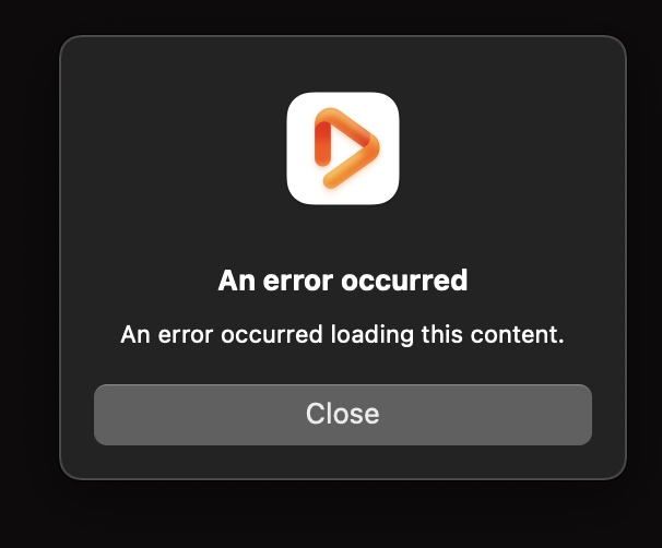

Why wont Infuse 7 play the following file?
It won’t play it on an ATV 4k, M1 MB Pro, or the latest M1 iPad

When you say it won’t play, what error message are you getting?

The error is “An error occurred loading this content”
