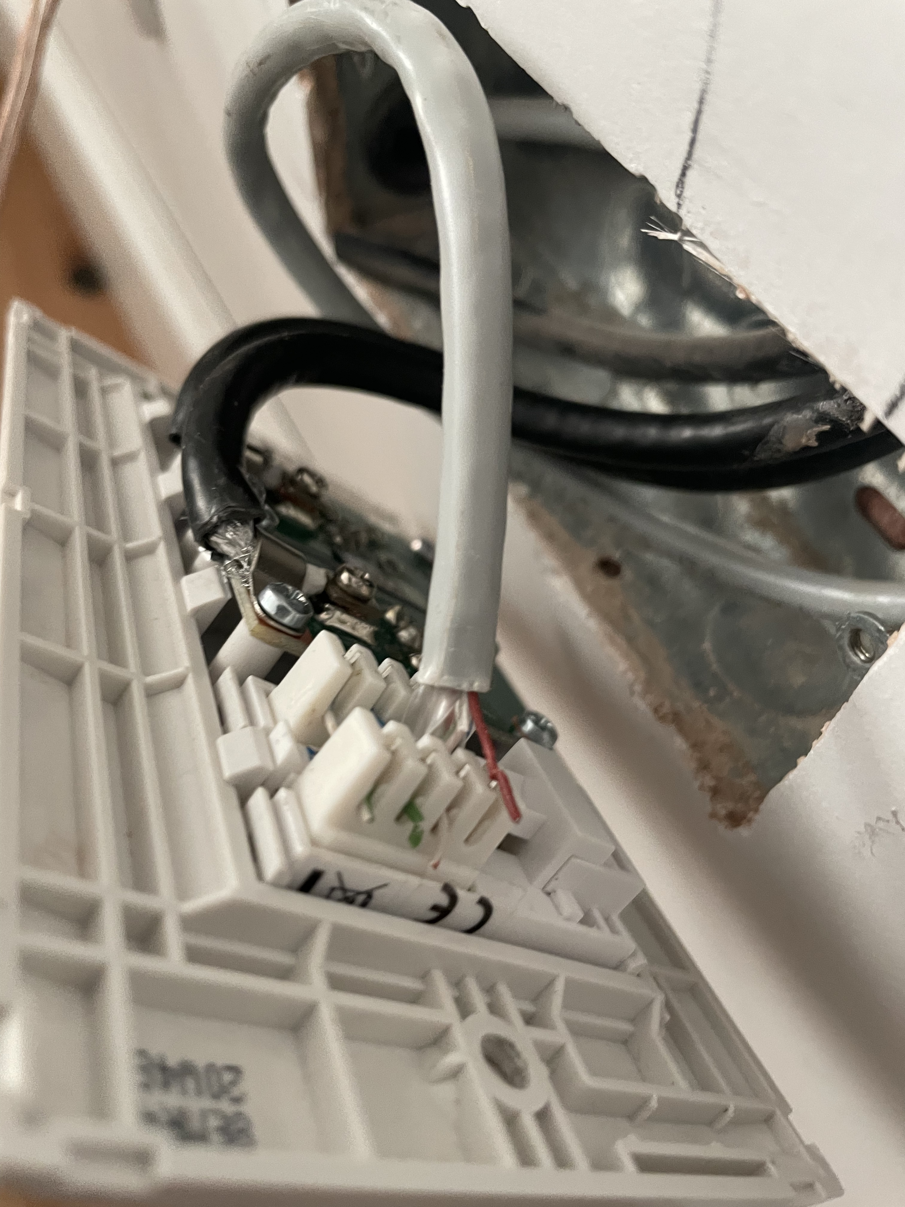

I found I had a disconnected wire in the RJ45 socket
The Infuse Spoedtest now shows around 400Mbps average speed (so 50MB/s)
