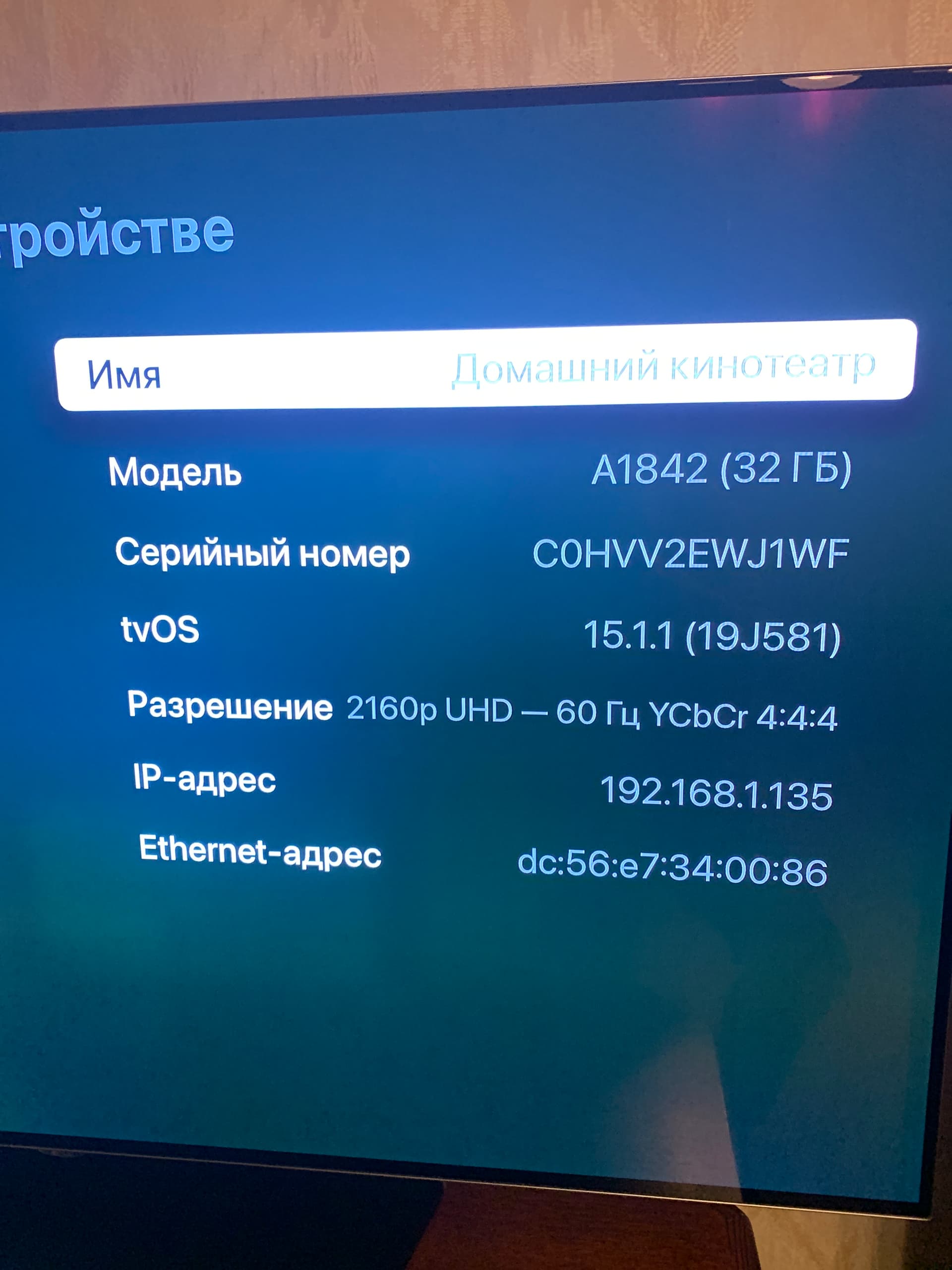

  1. Ensure the latest 15.1.1 software is installed

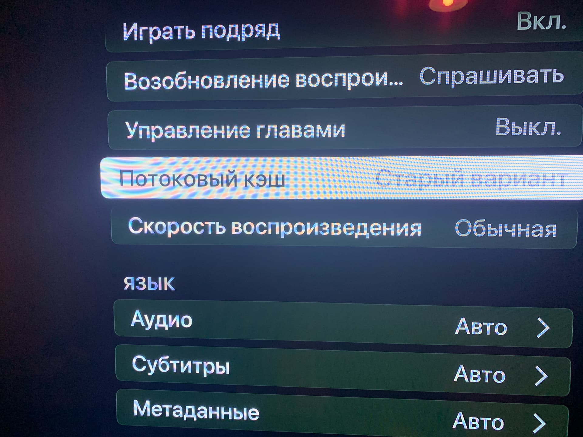

I have fulfilled all three points. But the presented video files still play with friezes. What is the system problem ? Are there any ways to solve it ?

It helped!
Reset ATV to Factory settings and Adjust the Streaming Cache option in Settings > Playback from Auto to Legacy.

Yes. Tested it. When i’m switch the mode to auto, the video starts playing with friezes again.
And yet the problem has not completely gone away. The friezes on the video began to appear much less, but they still exist. They appeared after an hour of viewing.

I sent a bug report 7KX3H, which was formed after yesterday’s manipulations and with legacy cache flow mode enabled according to paragraph 3 of the recommendations. But after that, the video still became with friezes.
