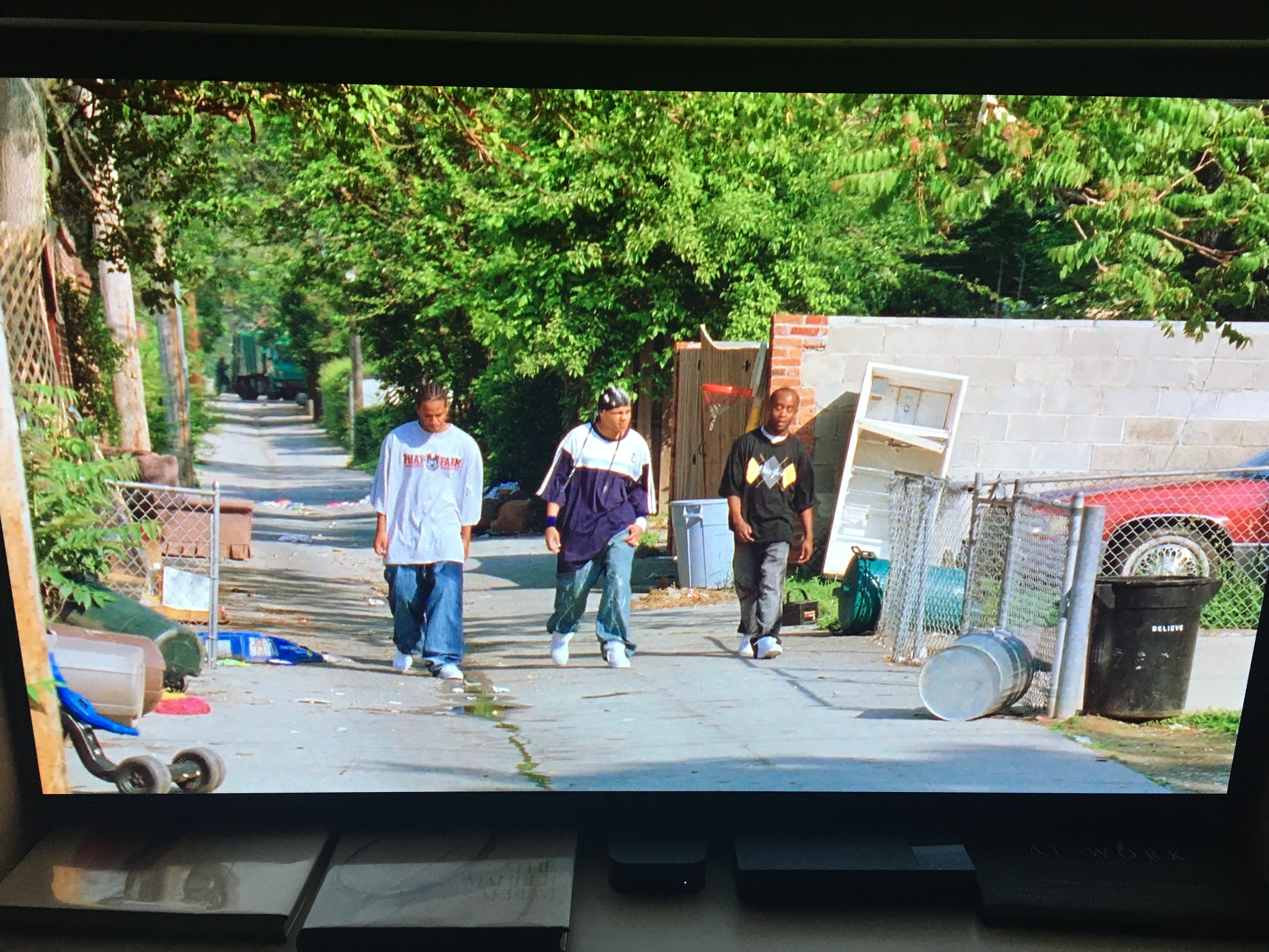

In addition to my issue with slow/stuttering playback, I’ve been getting this problem where sometimes, on initial play of a video, or when resuming from the Apple TV screensaver, white areas turn green. It goes away if you go back to the menu and start playback again. I have match range on, and I believe this may be related to range switching: menus / screensaver are in HDR, but the issue occurs with SDR content.
The issue:
How the scene should look:
