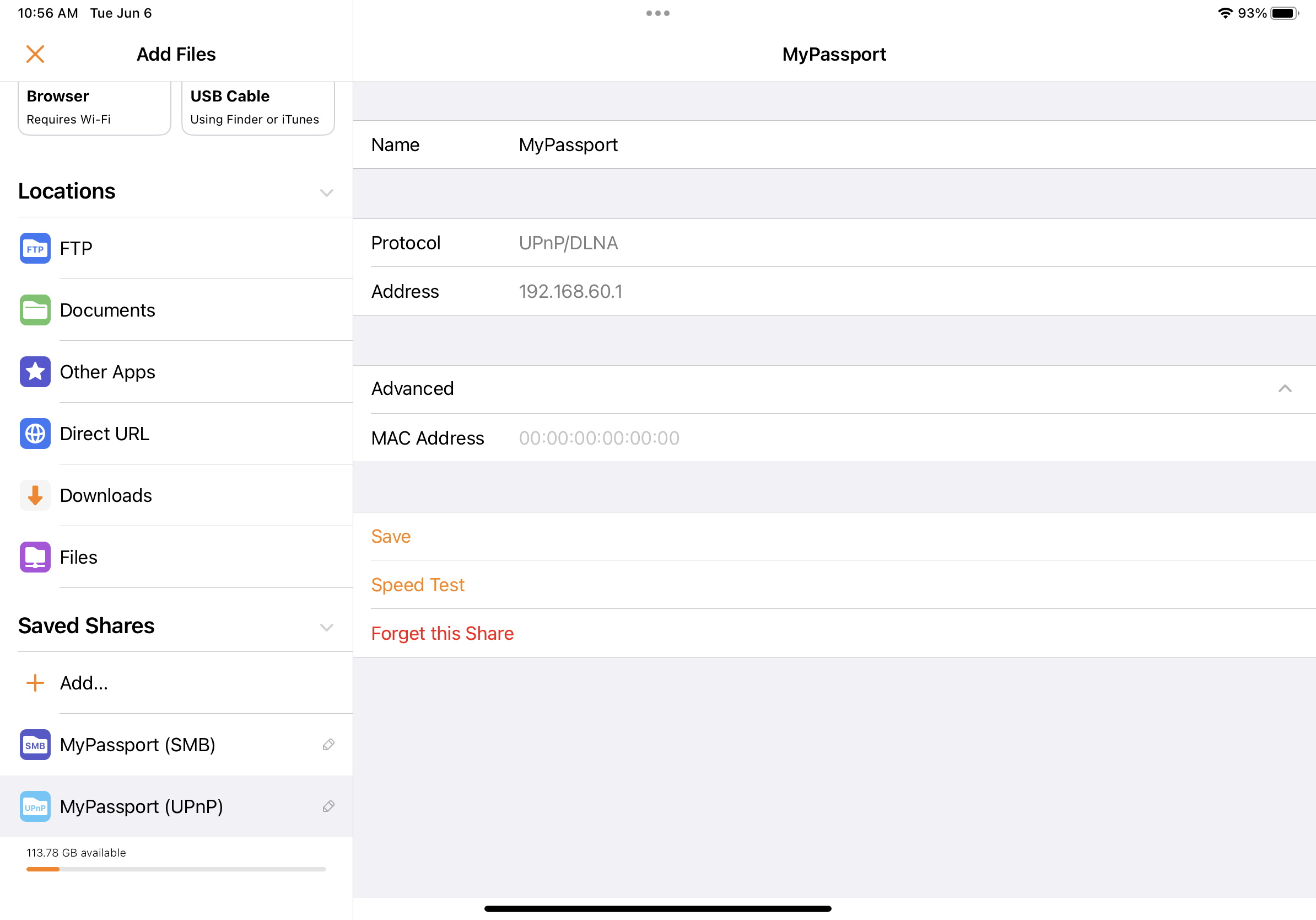

Infuse Pro 7 refuses to connect to my WD My Passport Wireless Pro locally/wirelessly through uPnP/DLNA. I believe it is because I can’t select a port for it in advanced. It just has a field for mac address and that is it. The other app, nPlayer Plus works. Though it inputs the port 9000. So that is why I am thinking why Infuse Pro will not connect.

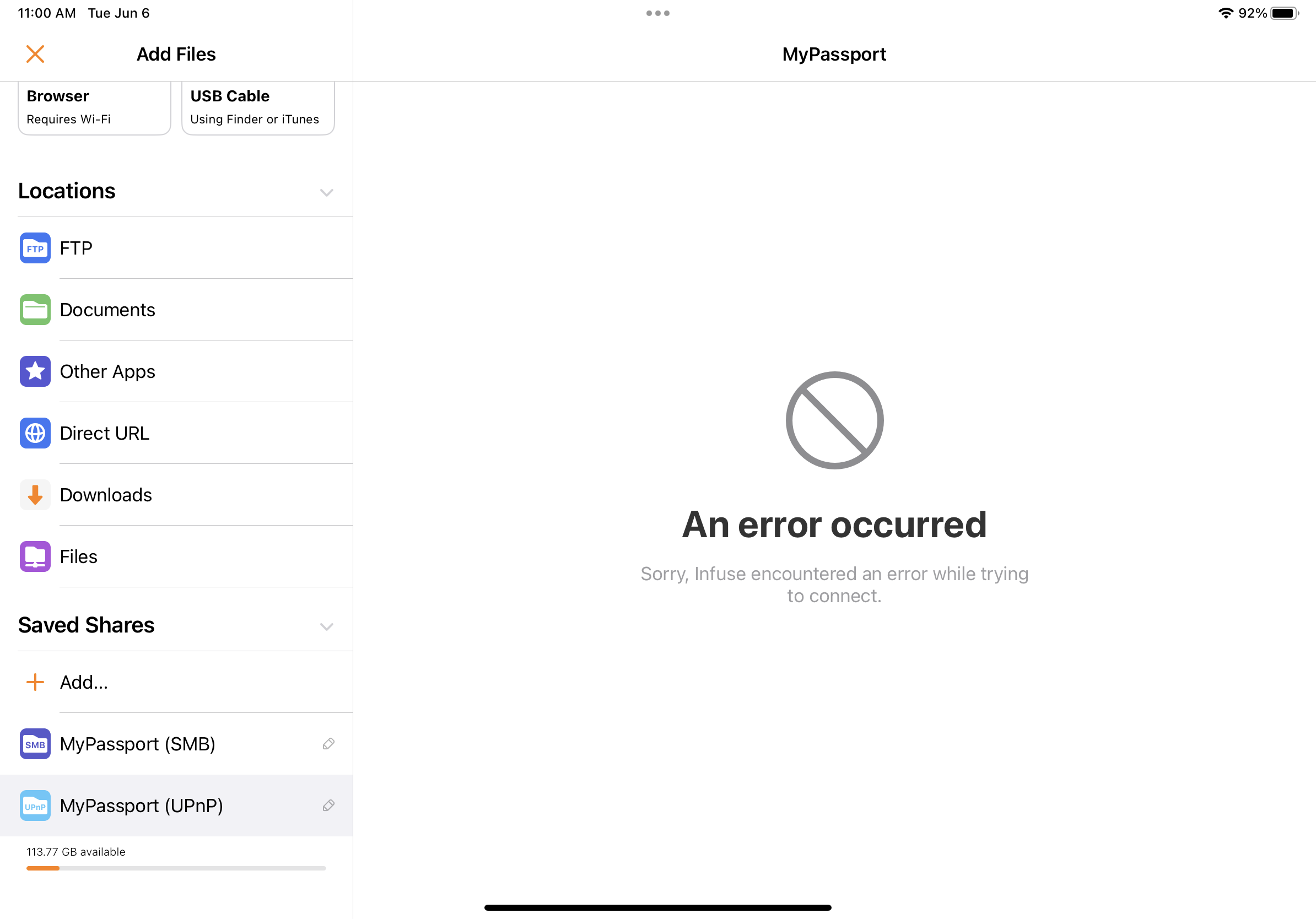

When I click save after 30 seconds to 1 minute

When you add the WD drive are you selecting it from the list of “Available Shares” or are you selecting “Other” and filling in the info?
The standard UPnP ports are 1900 and 5000, and unfortunately it’s not currently possible to set these manually for UPnP/DLNA shares in Infuse.

Ok I tried FTP it works so far better thanks. At least the speed test now there is no playback of any videos at all over FTP weird. :frowning: It says An error occurred loading this content.
