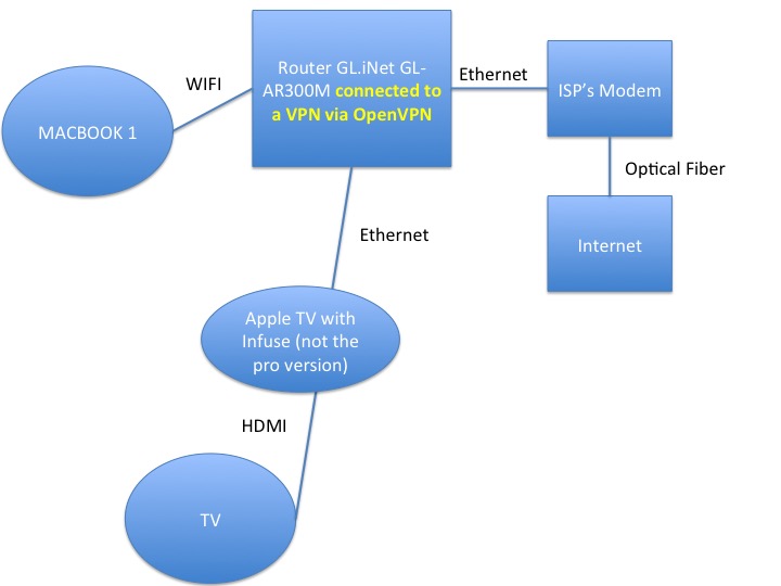

I need your help because I am not able to wake up my mac in order to stream with Infuse.
You will find attached my configuration.
On my mac I ticked “wake for WI-FI network access” and my mac and the Apple TV are on the same network.
I though that the problem comes from the VPN but I tried to disable it and it still not working.
Do you think that the problem could come from my router ?
Thank you for your help :slight_smile:
PS : I am sorry for my english, I am french.

The mac is a macbook pro (2011) with sierra.
Indeed, yesterday I tried to connect it directly to the ISP’s modem/router with an ethernet cable and to connect the Apple Tv to the same network in WI-FI and it is working !!
Yesterday I ordered a switch because I have only one LAN port on my router I really hope that it will work (I am a bit afraid because the router comes from a small brand and there is a VPN on it). I choose to have no internet connection if the VPN is not connected but I guess that the local connections are not going through the VPN right ? I am really sorry but all these things are new for me.
