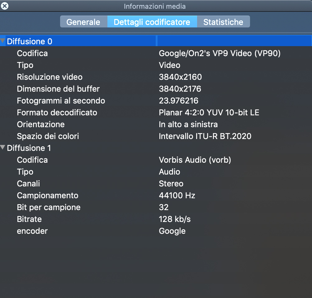

i have downloaded from YT a couple of4k videos (New York City 21:9 8k HDR // Relaxation Film - YouTube) with 4k downloader. I have uploaded them on my NAS and I noticed that with infuse (TVoS) the video is not played. the screen stays with the white spinning wheel on black background, but, when I go back, it is like the video was playing.
I tried to read them with VLC (tvOS) and it reads them.
i have attached the VLC codec infos and the 4k downloader screen to let you se what I have choose.

Infuse seems to take issue with the 10 bit LE encoded VP9 which is the 513.4 MB. If you DL the one just below it at 466.8 MB it’s a non 10 bit LE encoded and that one will work find on a ATV4K. It plays on a ATV 4 but very choppy.

now I have infuse 6 pro, we are in April and I have the same issue (attached a screenshot of the video played with VLC the Infuse do not digest)
can you please solve this?
thanks
d
Unfortunately, the Apple TV does not include HW decoding for VP9 videos, and as a result these need to be played with the less-efficient SW decoding option.
As of right now, 1080p VP9 videos will play, but the Apple TV doesn’t seem to have quite enough punch for 4K VP9.
