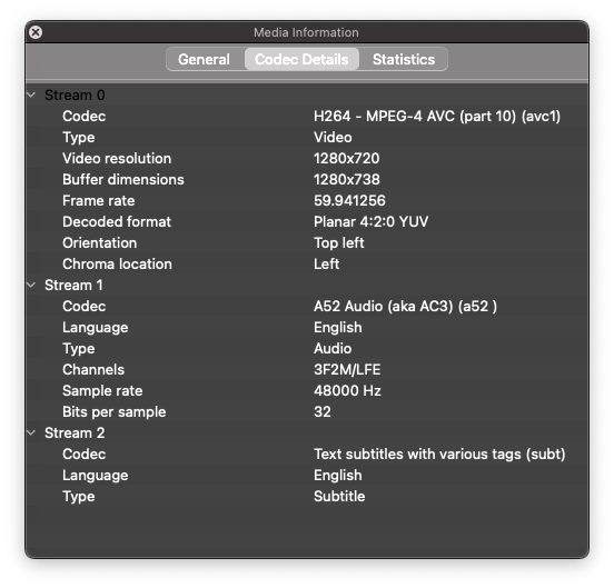

Example file that works fine with VLC but is jumpy with Infuse on Apple TV:

No buffering, it just skips ahead. Sometimes it’s a little sometimes it’s a lot. We notice it when watching Jeopardy because sometimes it jumps past clues or skips part of the final jeopardy song. Again, these files are fine on VLC.
