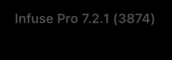

It’s the latest infuse -7.

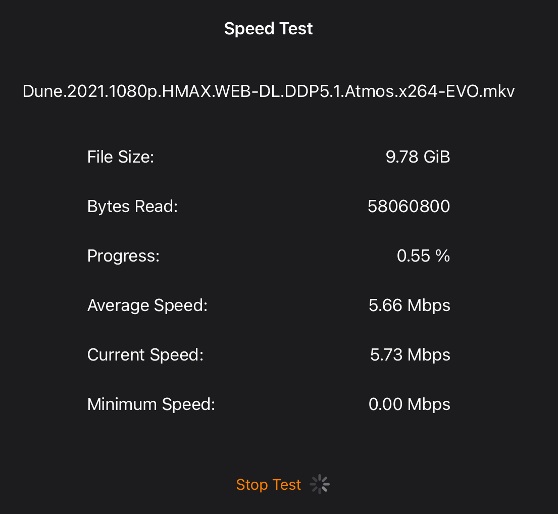

As for the test…

Well it could be 7.1 or 7.2…
Anyways those are some of the worst speeds I’ve ever seen so it makes sense you are having problems. Try changing your router or Ethernet cables connected to your router. Sometimes a router/NAS reboot/player reboot can help. Test it while being right next to the router as well.
Hmmm… Could the speeds be because I’m using an extender? Sometimes I’m really far from the router so I have to use one…

If your extender doesn’t connect via Ethernet then yes. If you’re running over 2.4ghz then that is also a problem.
An extender gives you half the bandwidth you’d normally have. If you want to have a good streaming experience you’ll need to be on 5Ghz.
