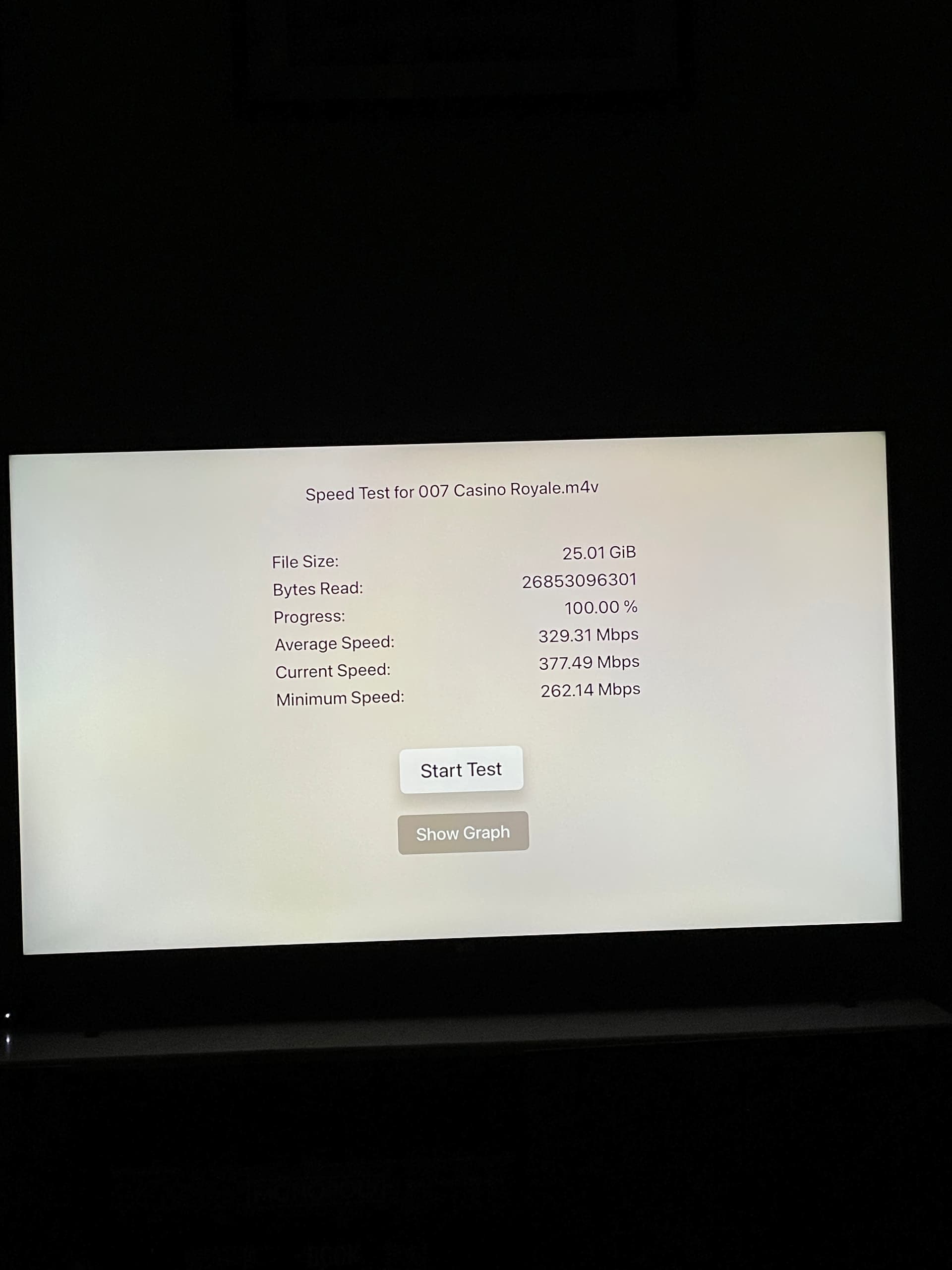

It may help to post what version number of Infuse and what version of tvOS you are running. Another thing that may help is to run a speed test in Infuse on one of the problem videos and let it complete, then post a screen cap of both the speed test and the graph.

Speed test over 455MB/s picture here:
This cap is at only 3.8% in so you may want to let it complete.
Letting it complete and also the screen cap of the graph may show better info and provide a more accurate evaluation
Also, the latest Infuse is 7.4.1 so you may wish to update yours.
Thanks,
My mistake I do infact have 7.4.1 on all Apple 4K TVs in the house.
Speed test complete - attached. I do not believe it is a speed / hardware issue - the setup has never had any issue with any content, only these VC-1 codec based files…
