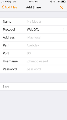

hi
i have a synology and and i created DDNS ip for external access…
but i couldn’t access my media out home by infuse using webdav
i follow the steps …
what i forgot?
see the picture and tell me what should i write on every blank …
thank you

Yes i did all the steps exactly… but
What should i write on (path) in infuse?
Hi, I am stuck in the same place, what to write in the path: when adding “other” share on iOS App. Thanks.
Me tooooo! I do not have static ipv4 address, but I can definitely access my nas through ipv6 address - in other apps! But when I tried to connect to my nas in infuse using WebDAV(http/https), never can I reach the nas(with local ipv4 address I can). How come such thing happens! I thought ipv6 is totally supported by infuse already!
One possible factor is my SSL certificate being not accepted by infuse, but some other apps can connect flawlessly. I don’t understand why.
