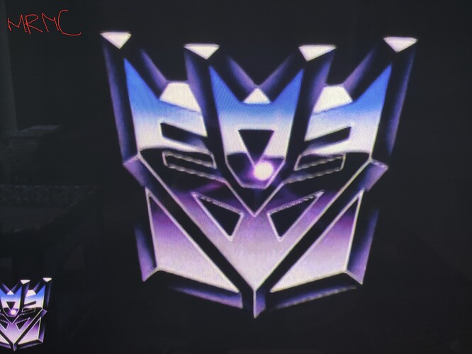

I’m not sure what is wrong but this dvd material look on Infuse really bad “very jagged edges”
I tested this on all my players(MrMC also) and problem is only on Infuse. Please look:

Which Apple TV model do you have?
Since this is an interlaced video, you may try adjusting the Deinterlacing setting found under the Video tab of the Playback Menu (swipe down while a video is playing).
Apple tv 4k 1gen and 2 gen.
I tested Yadif & IVTC and is much better BUT this good/best mode is not selected automatic why?

Infuse 7.3 is now available and uses Yadif as default on ATV4K and newer.
If you prefer a different method, the setting will now be retained when playing different videos.
