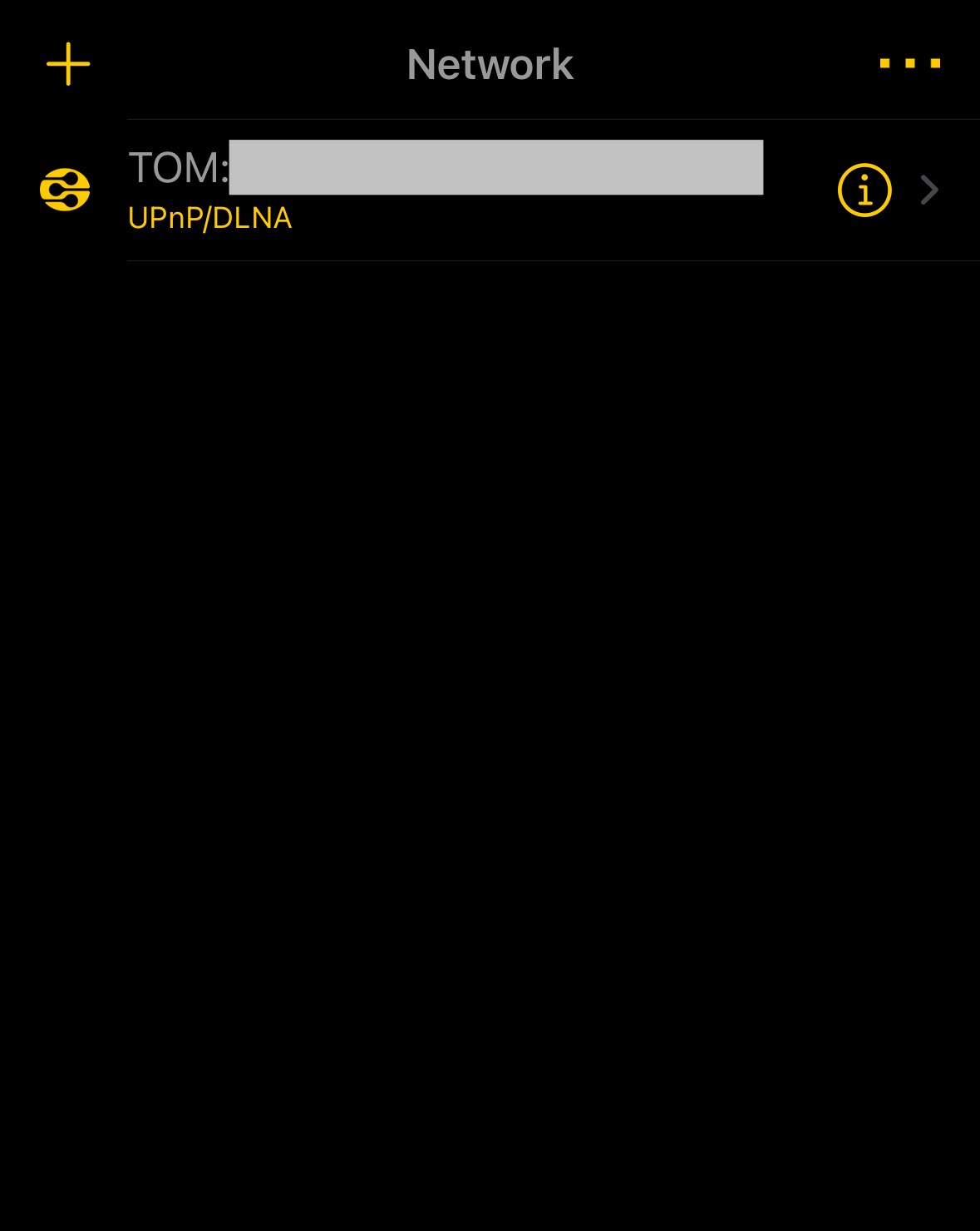

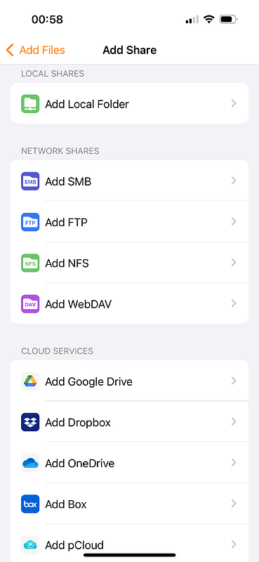

It’s just my computer using media sharing, it used to show up in local shares when adding files but since the last update nothing shows up in local shares at all anymore not even my router, I can still transfer files via web browser atm.
I downloaded n player to see if it was the pc at fault but I can access it from nPlayer completely fine and on my tv I can also access it
Not sure what’s causing it tbh it’s very odd but it’s only infuse not showing it
First image shows nPlayer second is infuse

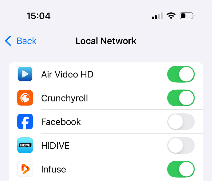

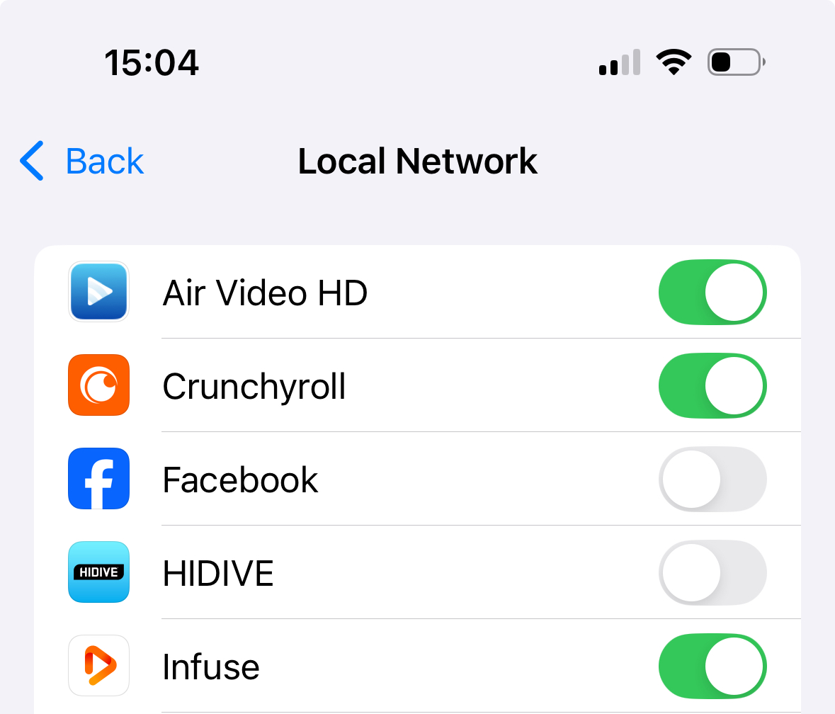

One thing to double-check is to ensure Infuse has access to the local network. If this is off then Infuse won’t be able to see or connect to any local network devices.
Note: I believe this is supposed to remain enabled after installing Apple system updates, but for me it became disabled (for all apps) on 2 different Macs when installing macOS 15.4 this week. Not sure if there are similar cases on iOS.
yeah that seems to be enabled
So the behaviour is as follows
I go to add files nothing shows up in shared like it used to, however if I wait like 8-10mins the UPnP share will show up if I add it all I get is a spinning circle when trying to open it
If I go to nPlayer on my phone the UPnP share shows up instantly and works as it used to in infuse
