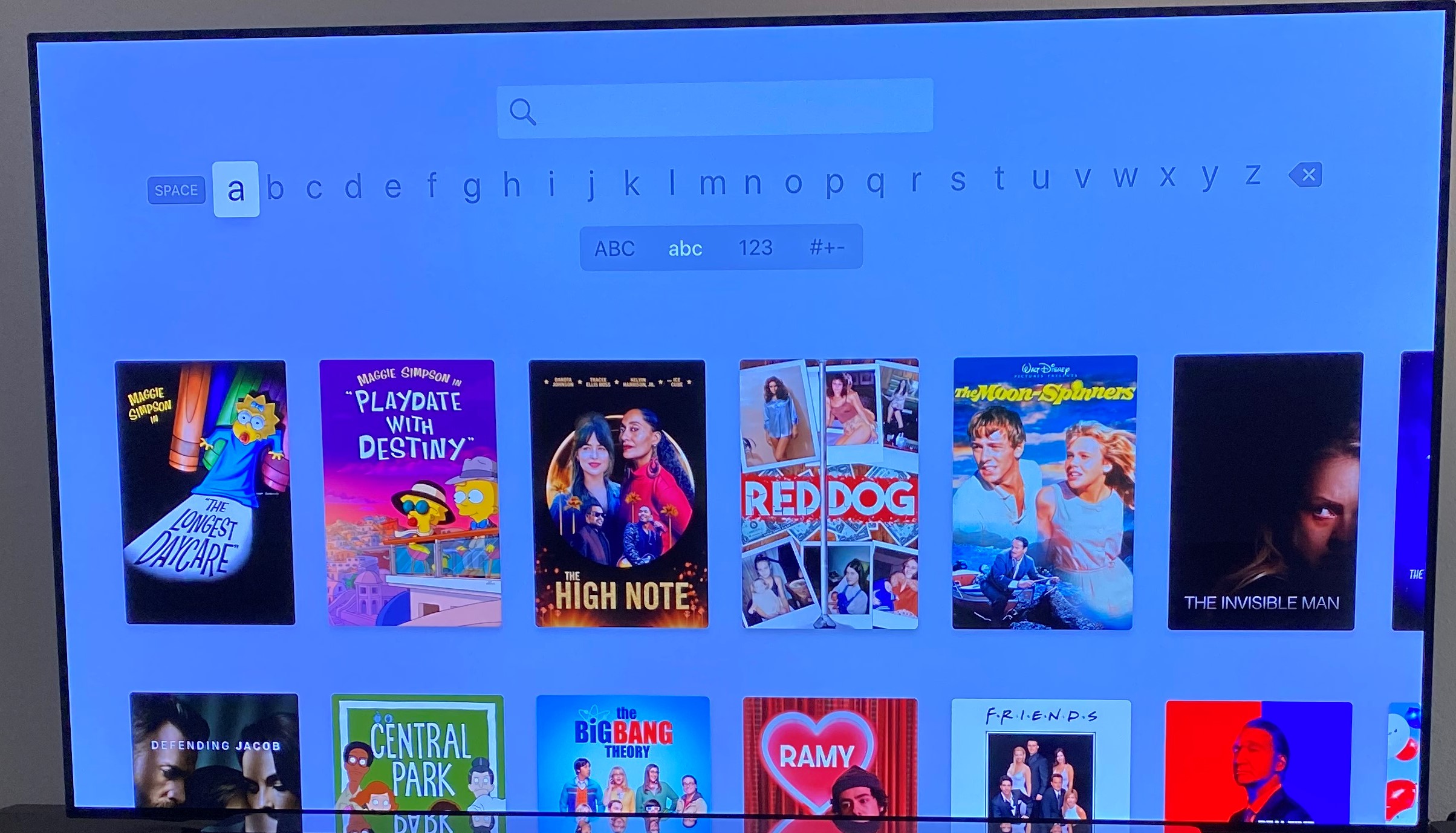

Could you provide a screen cap of the screen you are in when you press the microphone button? Just to make sure we’re on the same page.
Here are the screen caps you requested.
This is what I get after selecting the edit button and then use the mic button.
Here’s a better look at what is happening.
