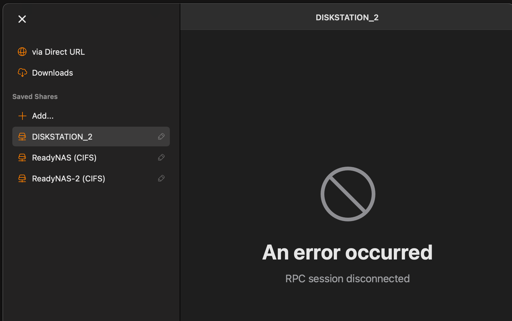

Ah, I see—I made the updates to Infuse’s settings. After entering the device’s MAC address, it did seem to initially help… but the problem cropped up again as I continued going through to correct mismatched titles.
Something I’ve noticed this time around is that when I go to Edit Shares, I am getting an “Error Occurred: RPC session disconnected” on the Synology device, whereas the two ReadyNAS devices are fine.
The NAS is definitely still mounted and connected and the directory read without issue in the Finder, so I’m not sure why the RPC session is becoming disconnected or how to re-establish a connection.
Also, I noticed when I Edit this Share that the username & password are greyed out—I typically log into this device with my Admin account, but currently it shows the default “johnappleseed” account without the ability to change it. Perhaps part of the issue is that I’m not logged in as an authentication user from Infuse?

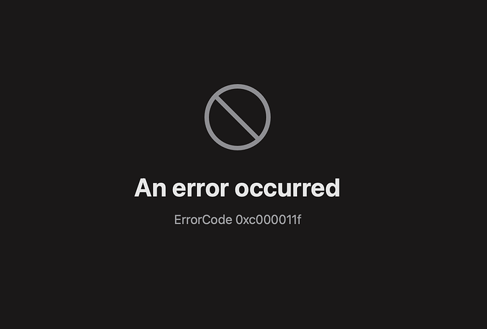

I’ve just tried forgetting the Share and re-adding it—this time specifying my usual username/password to connect, in addition to making sure the MAC address (and Workgroup) were filled out.
It initially began to repopulate but while I was going through to correct mismatched titles (again), it began overwriting all of my local Cover artwork with versions pulled from the internet—and a few seconds after that, I was ejected from the Library window and began receiving “An error occurred: ErrorCode 0xc000011f” and for now can no longer connect at all to the Share.

I have the same problem as you describe in your post on oct 14…
I also did everything what was suggested but the Infuse app still shows the same problem RPC session disconnected, and the app does not play any video…

I’m trying to look closely the setting in Synology and try to figure which one i have to change in order to get a smooth and stable connection between Synology Nas and Infuse… I suppose that we would not get valuable assistant from Infuse or from Synology either… We are left on our own to figure it out with trial and error… If it works smoothly I can share my finding with you… and the whole Forum here.
Can you try adjusting the SMB version in Infuse as described here.
You may try using SMB2 or Legacy to see if things work better.
Thank you… I’ve tried…it’s ok I have matched the SMB setting i have on Synology with the same setting in Infuse… it works better now, but sometimes I have the same message “RPC session is not in progress” … later on it came back… I hope it will work well later on
