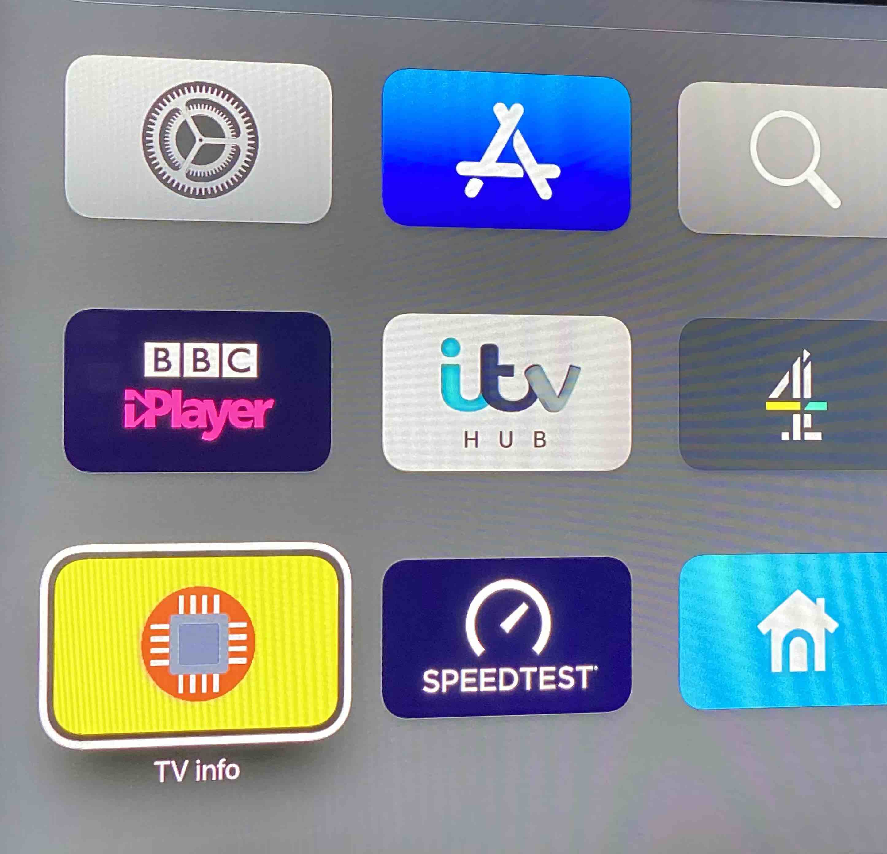

Next - James why on gods earth do you not know about this APP ???
GKAR - download it to your ATV - see below …
You will note that the information from my unit shows that I have 5.94 GB free - representing 20% Free

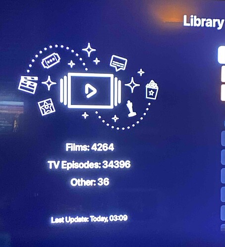

OK - so next …
You can see that at the moment I have 37,000 items of Media (showing the breakdown)

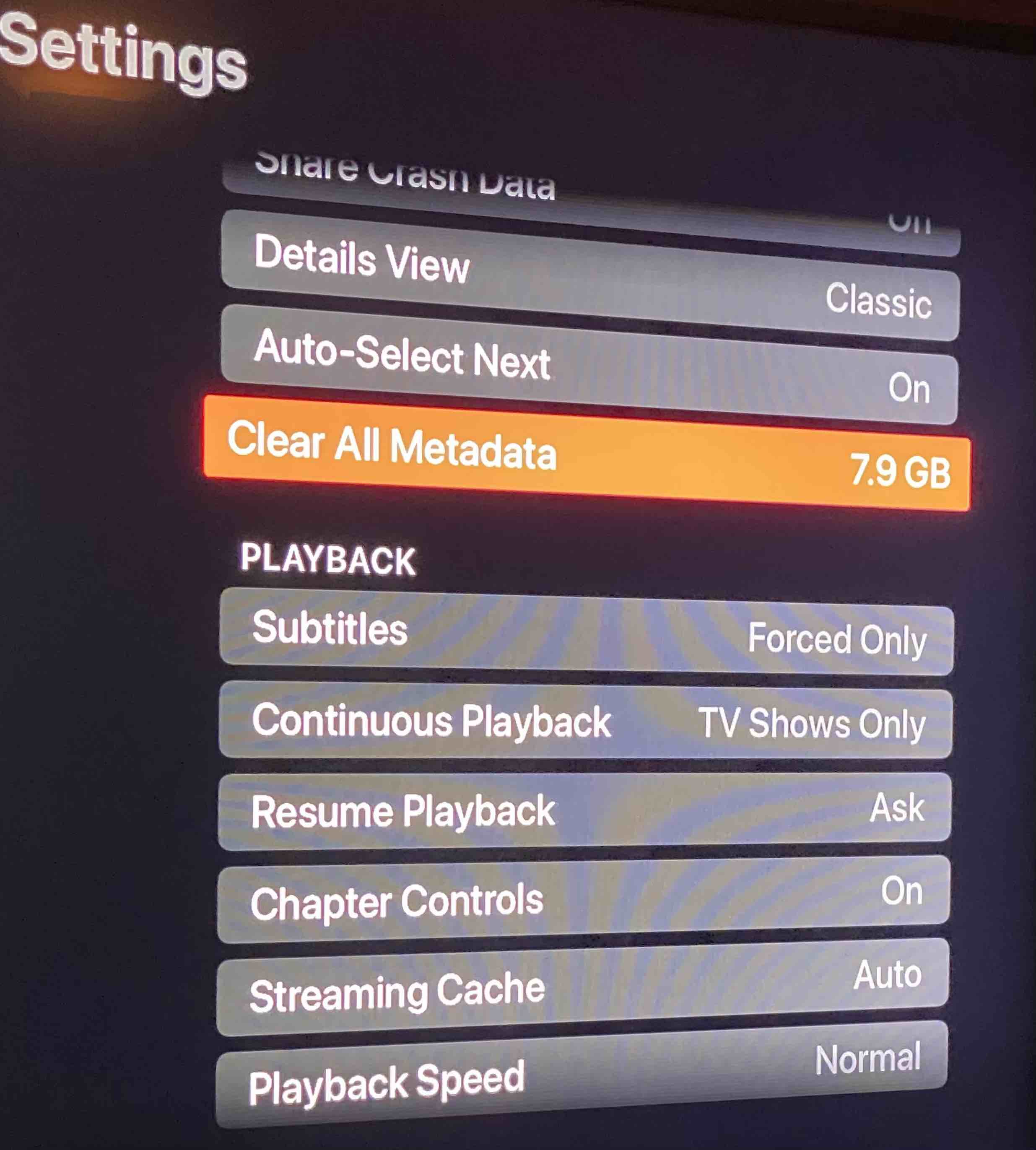

and finally …
You can see that all this data is using 7.9GB of space.
Simple maths average will estimate that a TOTAL of 61,000 items will use ALL available space on my ATV - HOWEVER, the ATV will never allow it to overflow and will delete at a threshold of maybe 5% less … so again estimating, I would think that something like 55,000 items of Media will trigger a delete of ALL the Infuse Metadata.
