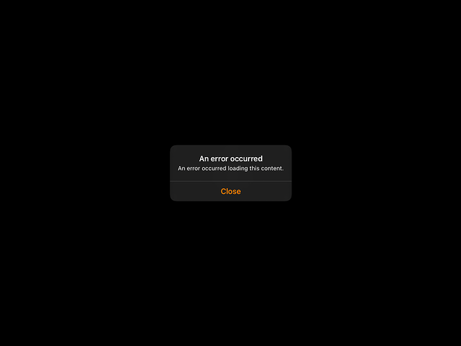

While sometimes video playback on my iPad and iPhone are very smooth, other times videos will be stuck on the “Loading…” screen for minutes until a dialog pops up saying “An error occurred loading this content”.

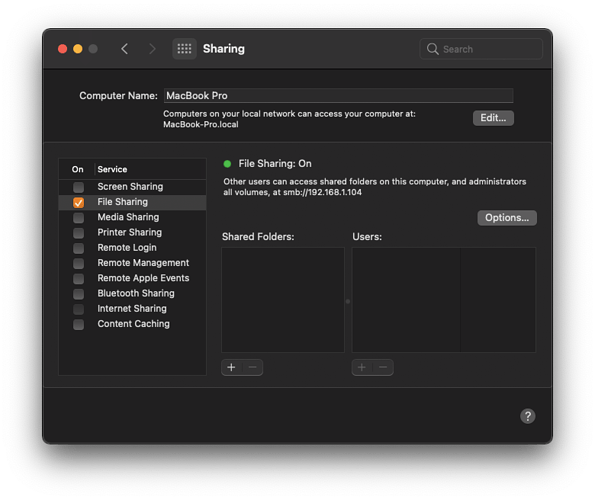

Maybe to rule out the drive going into low power or sleep you could create a small SMB share on the internal drive of the mac book and see it that reacts the same.
Could you explain in a bit more detail what’s happening? Is it starting to play and then goes to buffering or is it when you start the video it just spins and shows the error?
I don’t quite understand how to configure this. Am I supposed to create “a SMB share” for every directory? I was under the impression that I just needed to flip a switch to “turn on SMB” and other devices would be able to access all the files my laptop had access to, so I didn’t add any folder to the list of Shared Folders:

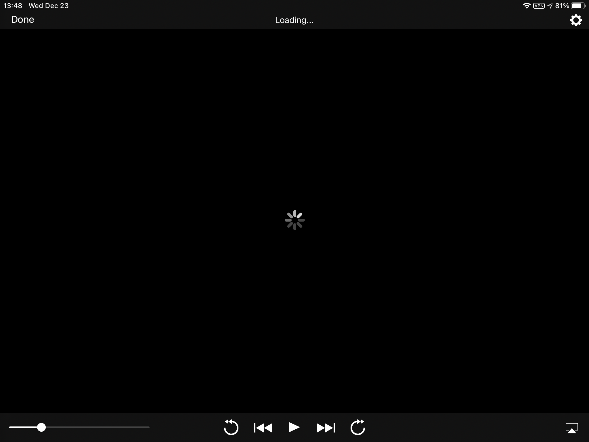

When the issue occurs, the videos won’t play at all. After I hit the thumbnail, I’ll see a black loading screen:
But when this issue temporarily resolves itself for no apparent reason, playback is buttery smooth. I watched a TV episode in Infuse on my iPad before sleep last night and the experience was flawless.
