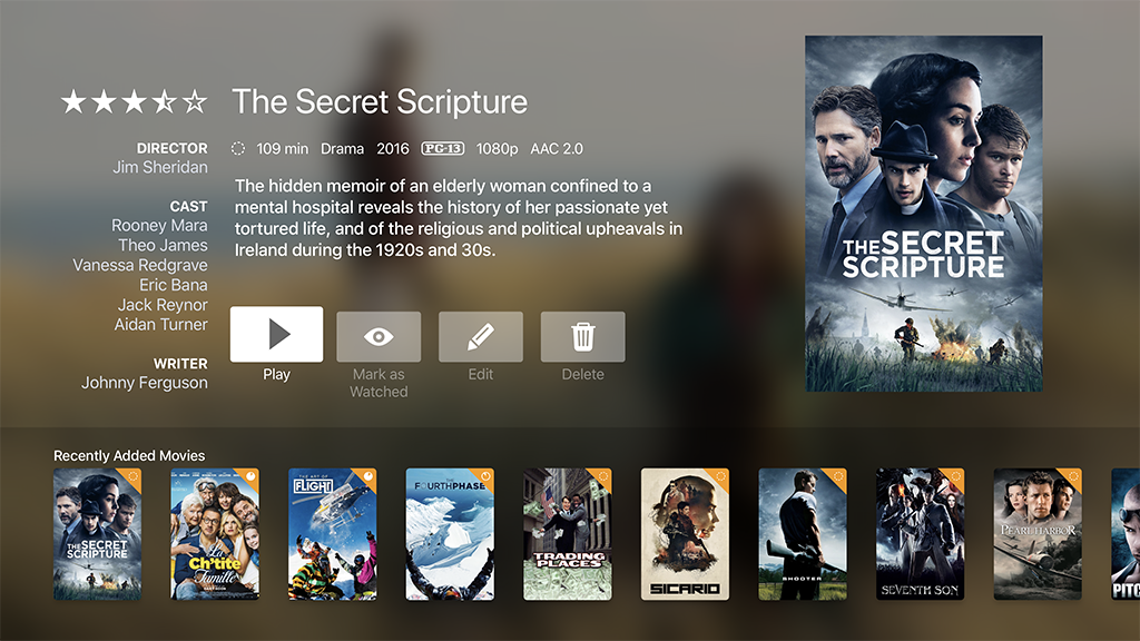

In general I get 100% accuracy with Infuse’s movie identification, when I use the exact name and year found in tmdb and tvdb. But this one stumps me. I have the movie “The Secret Scripture (2016)”. When named exactly as per tmdb, Infuse instead identifies it as “Kingsman - the Secret Service (2015)”.
I can go in manually and edit the metadata, and the correct movie shows up in the list of choices, but this is silly. Infuse doesn’t even need to guess the right movie in this instance. I’ve given it an exact match and Infuse refuses to use it.
Why isn’t Infuse picking the name-identical choice here? On my Android TV with Archos Media Player it identifies correctly without a hitch.

I assure you that I’m familiar with the naming convention. But in this case, none of those special character issues appear in what I am naming the file. I can call it “The Secret Scripture (2016)” or “Secret Scripture, The (2016)” or even just “The Secret Scripture” and it pulls up metadata for “Kingsman: The Secret Service (2015)”.
It’s especially weird because I often get more accurate metadata by specifying the year in my file name. Doing that sorts out potential ambiguities before they happen. It didn’t work here though.
And naming my movies in French shouldn’t be the answer! Just to confirm - The Secret Scripture is an English language film, it has NO other primary name or alias, no Americanised spelling, and a web search on TMDB pulls it right up. Like I noted in my original post, I use Archos Video Player on my Android TV and it parses the exact same file on the exact same NAS drive perfectly.
All I can conclude is that Infuse, when indexing off TMDB, is treating colons or other punctuation marks incorrectly so that Kingsman: The Secret Service actually appears a closer match than a movie with exactly the same name as the correct item.
As I said in my post, I’m still digging into “The Secret Scripture (2016)” issue. I too have tried just about every combo I can think of with the same results. There’s another oddity with this movie, while it’s original release date was in 2016, according to themoviedb it was released in the U.S. in 2017 so I thought I had found the issue but no matter what year I tried it still came up with the dang Kingsman movie.

I’m going to keep on hammering on “The Secret Scripture (2016)” to see if I can get it resolved. Thanks again for the input.
