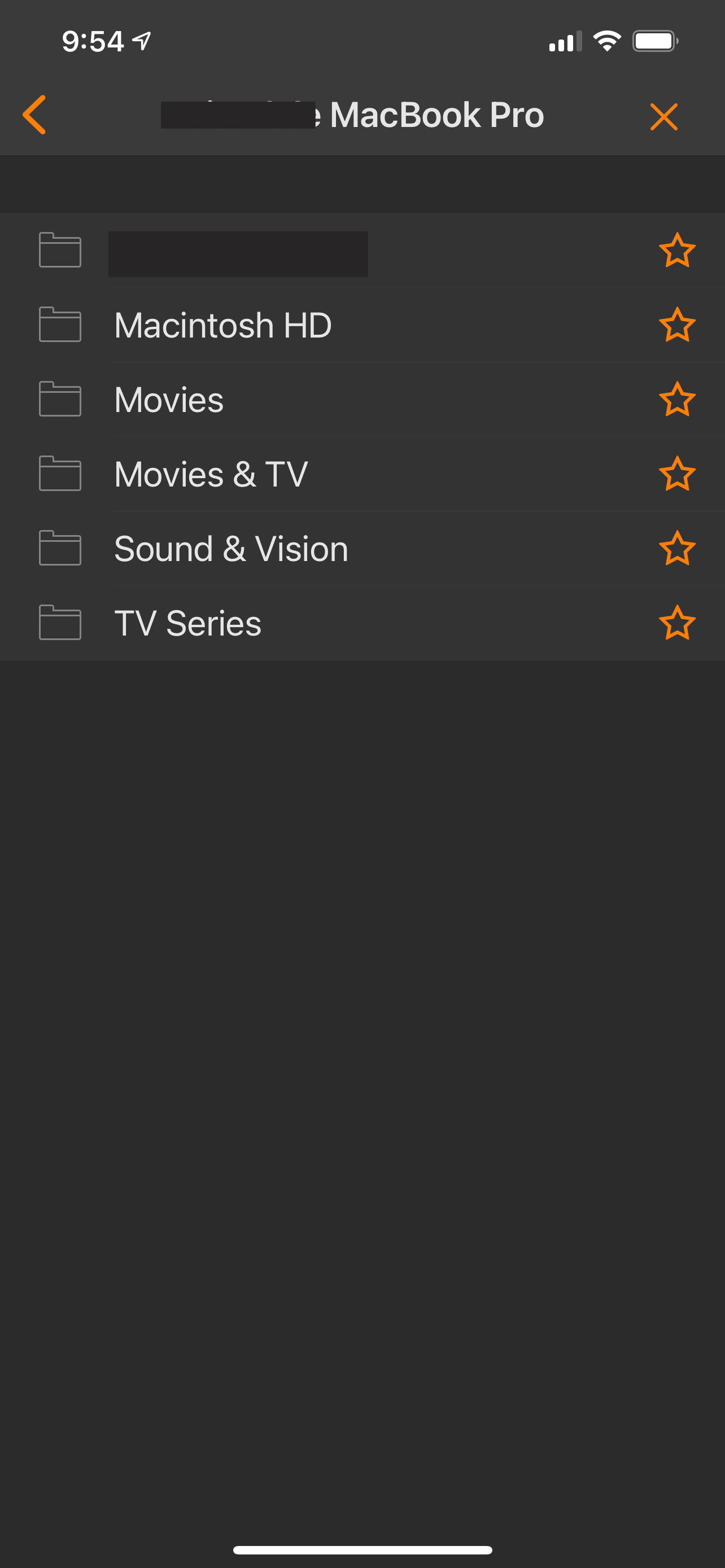

Struggling to figure this out. I have followed the instructions to share a drive in MacOS Big Sur, and can see the drive, create a share in Infuse, and make a favourite. But when I try to view the contents, I get told I don’t have access. What am I missing?

An update. I am using an external drive which is partitioned which appears to be the problem. I have tried sharing the drive partitions, and also the folders within the drive partitions. Neither work despite the drive partitions showing in the Add List as you can see in the attached screen shot from my phone. The Sound & Vision partition is not shared so not sure why its showing.

Yes. Ive shared both drives and folders. Though the weird thing is that attached drives show up in the files list even though they are not shared.
