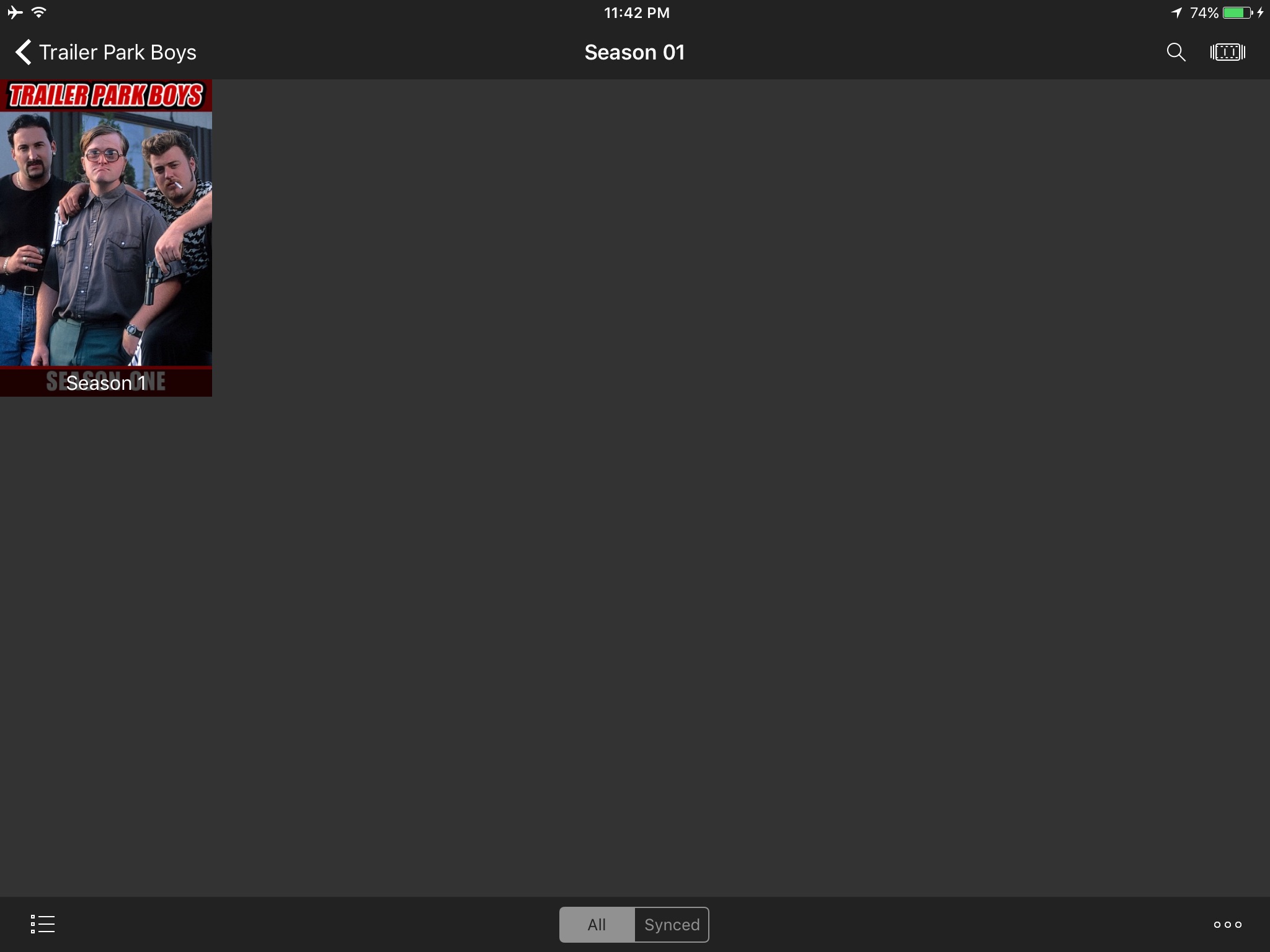

When browsing in File Mode + Grid Mode, I open the Trailer Park Boys series folder (which has correctly fetched artwork). I am now seeing 7 Season folders (artwork fetching not available). Once I open one of these season folders, I am met with an additional season folder level (this one with correctly fetched artwork). After I open this 2nd level, I can then browse my corresponding season episodes.
So essentially what is happening is that Infuse has created a double layer of Season folders. Here is an example of the filepaths:
/Trailer Park Boys/Season 01/Season 01/season-1-episodes
/Trailer Park Boys/Season 02/Season 02/season-2-episodes
/Trailer Park Boys/Season 03/Season 03/season-3-episodes
…And so on…

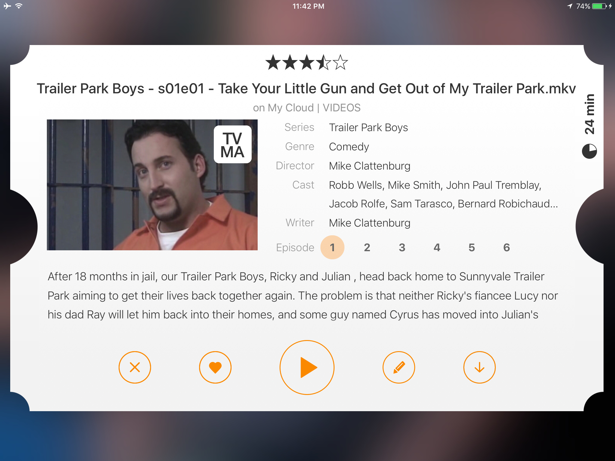

FYI: My episode files ARE NAMED CORRECTLY, and even they are fetching the correct metadata. Also, this issue does not occur in Library View, and it only happens when browsing File View with Grid View.
I have included some p0hotos walking you through the process of opening Season 01

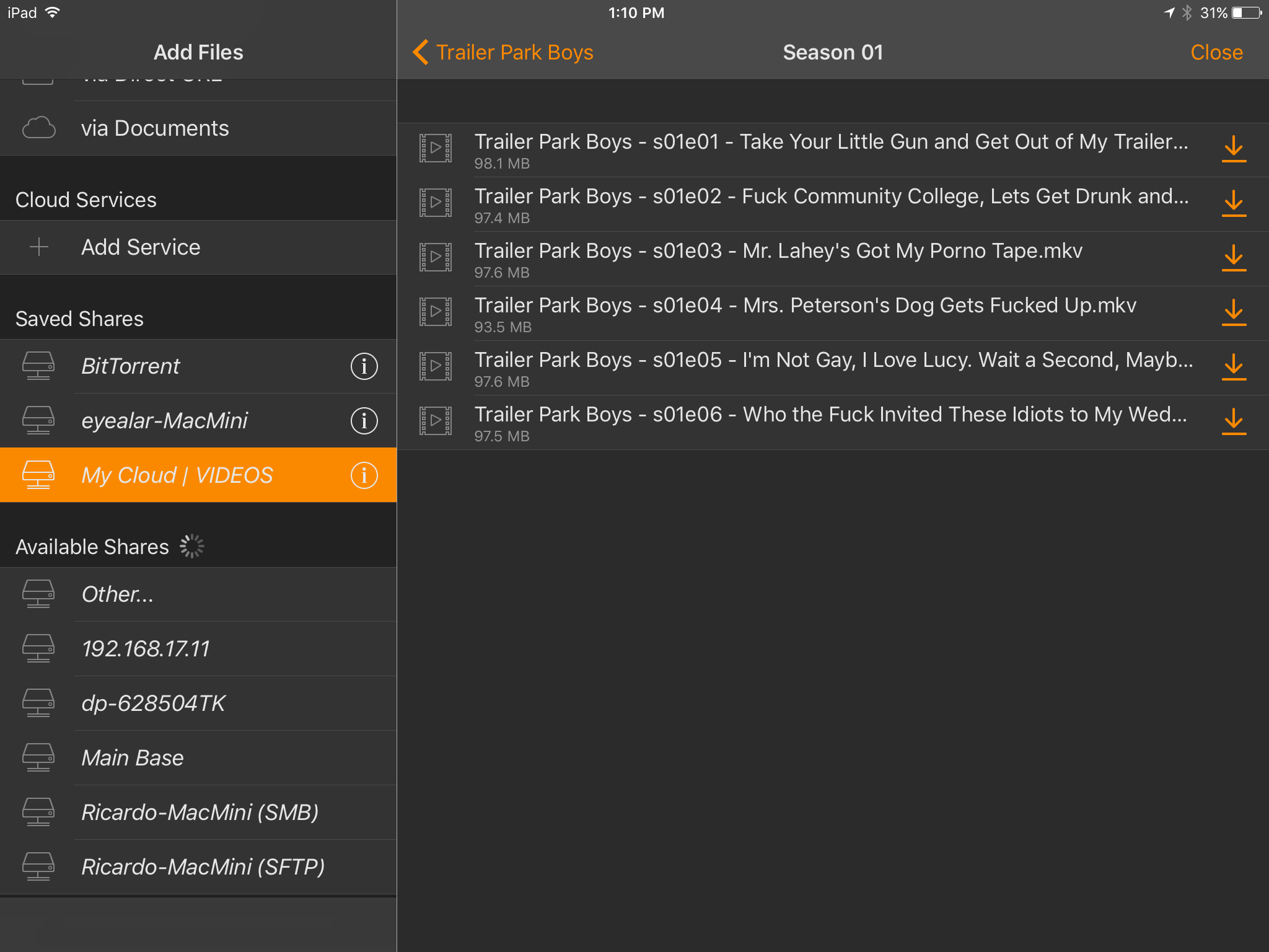

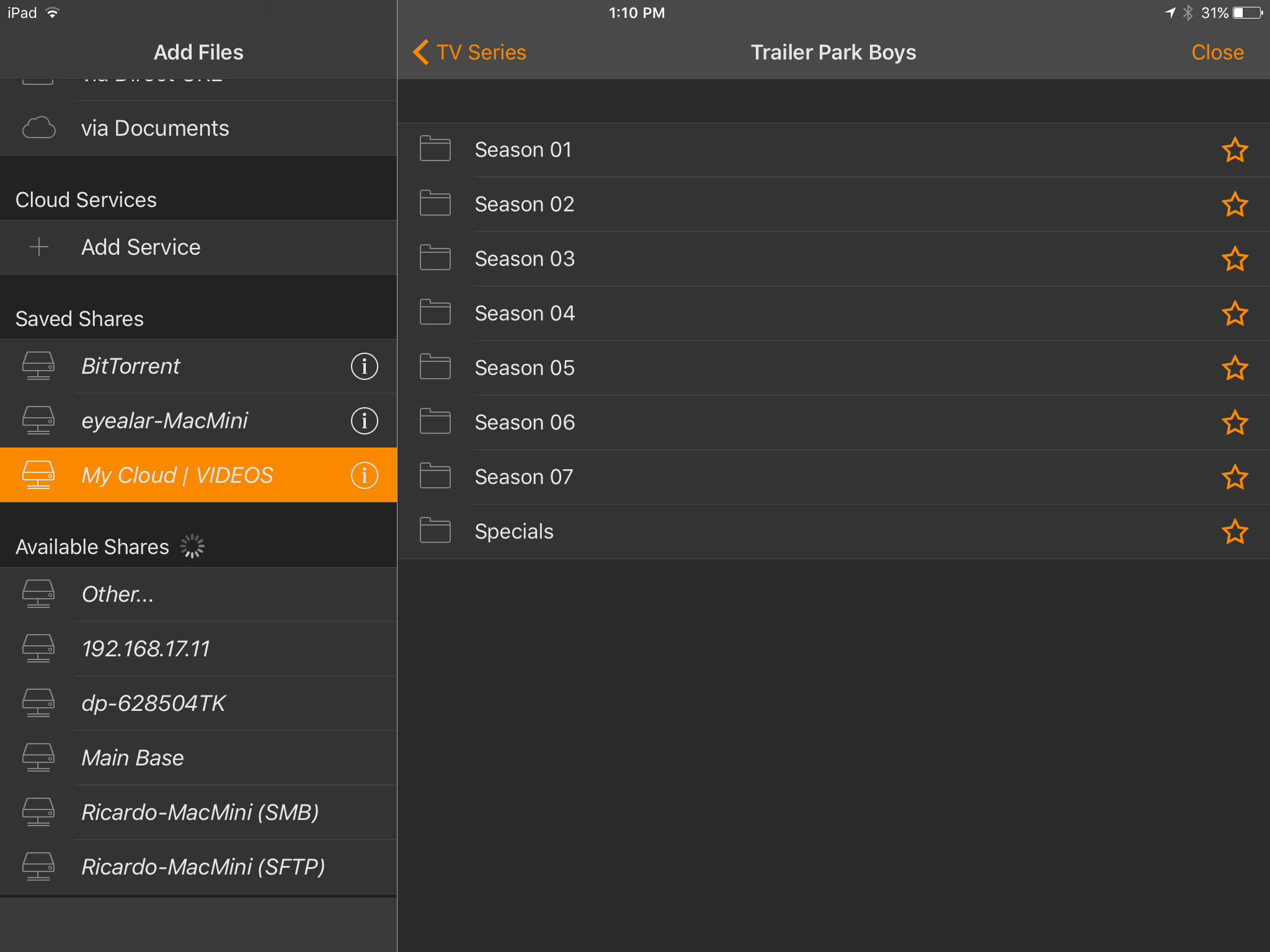

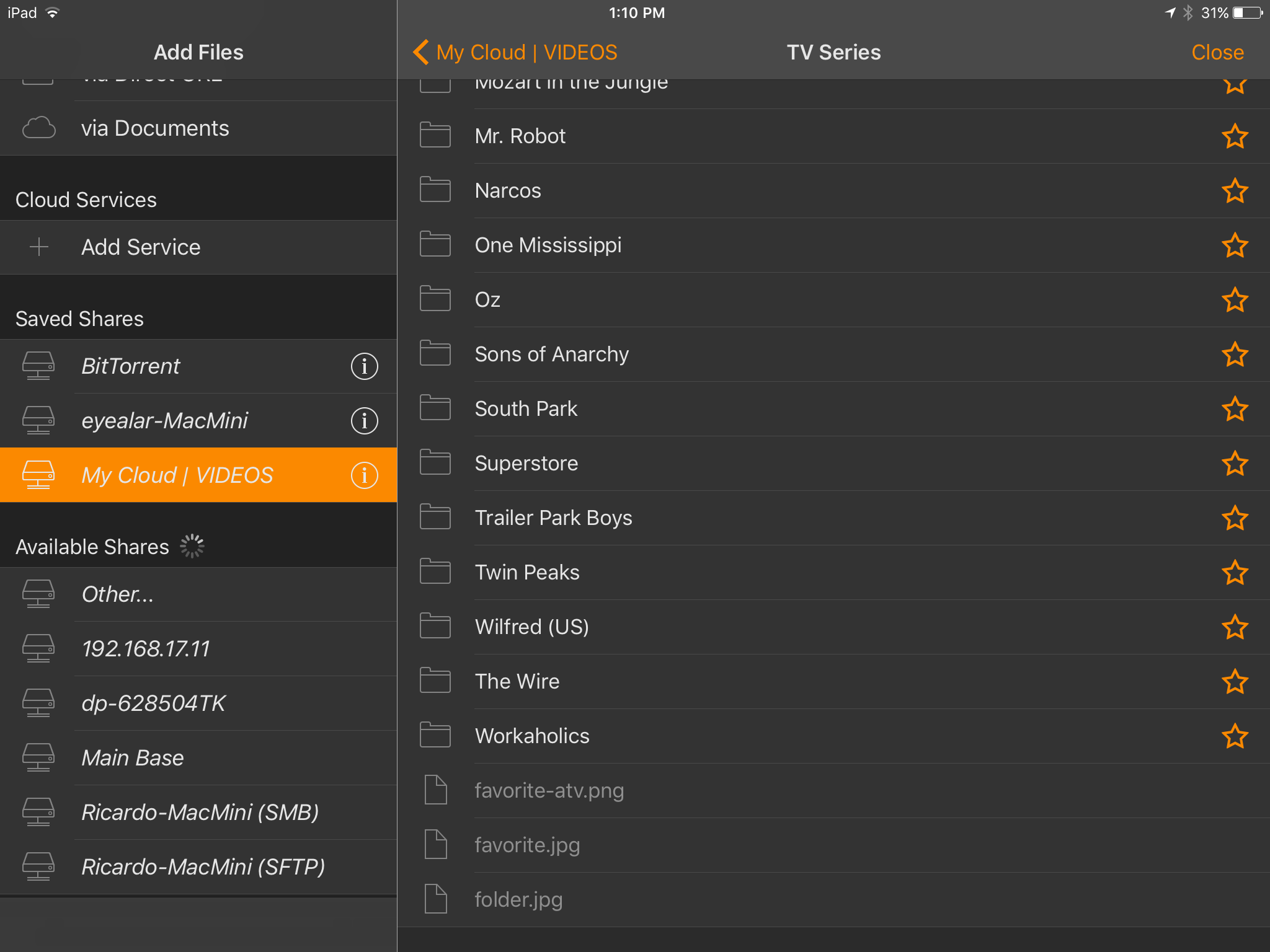

What type of device are you streaming from?
Does the correct structure appear when browsing this share through the Add Files screen?
I am streaming from 2 devices:
  • iPad Air 2 (iOS 10.3.3) + Infuse Pro (5.5.3)
  • Apple TV 4 (tvOS 11.0) + Infuse Pro (5.5.3) – issue was also occuring when ATV was on tvOS 10.3.3
The correct folder structure DOES appear when browsing this share through the Add Files screen. I will include the screenshots just so you can confirm.
So just to reiterate, the following applies to both streaming devices:
  • This issue is only occuring while browsing in the (classic) File Browse mode with Grid View turned on.
  • This issue does NOT occur when File Browse has List View on.
  • It does NOT occur at all with Library View.
