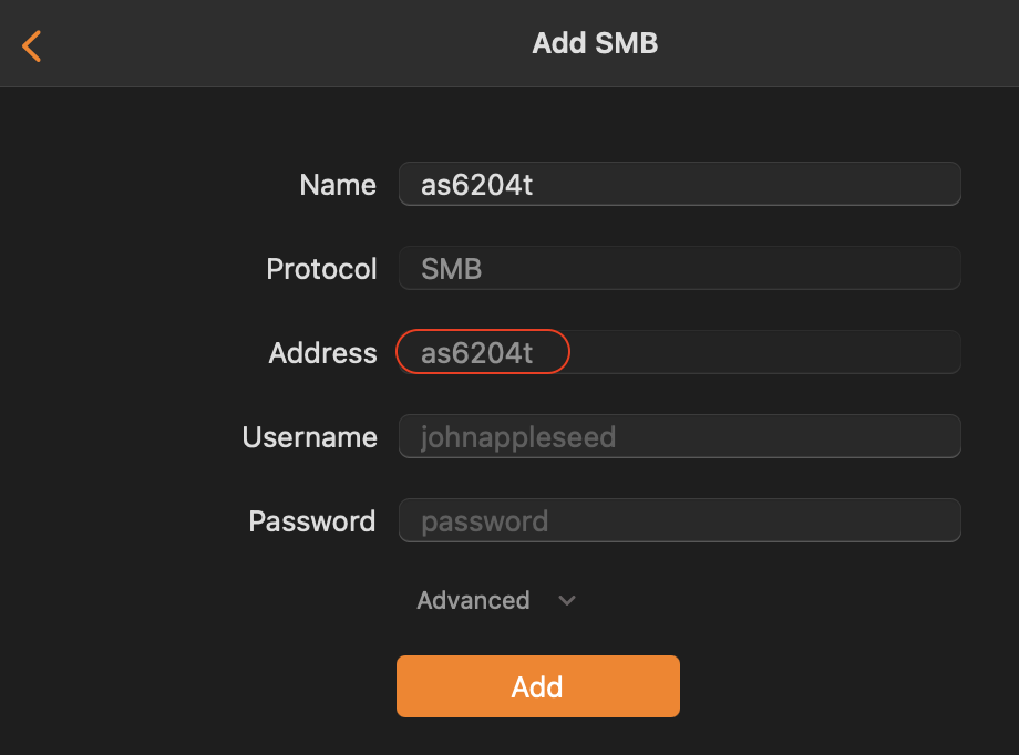

The NAS shows up on Saved Shares, but throw an error while trying to connect. After choosing Forget this Share, the NAS reappears on Available Shares but I’m still unable to connect to it. The Favourites placeholders from the AppleTV do show up on the Files tab, but throw the same error.

Success! The trick is not to use the NAS from the Available Shares, which has the address field prepopulated with only the name of the NAS (not editable).
Instead use the Add SMB option, where you type the name of the NAS and add .local (which seems to be required).
