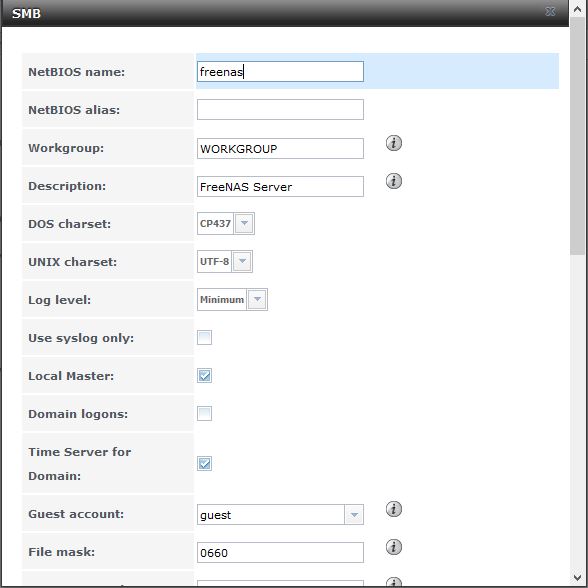

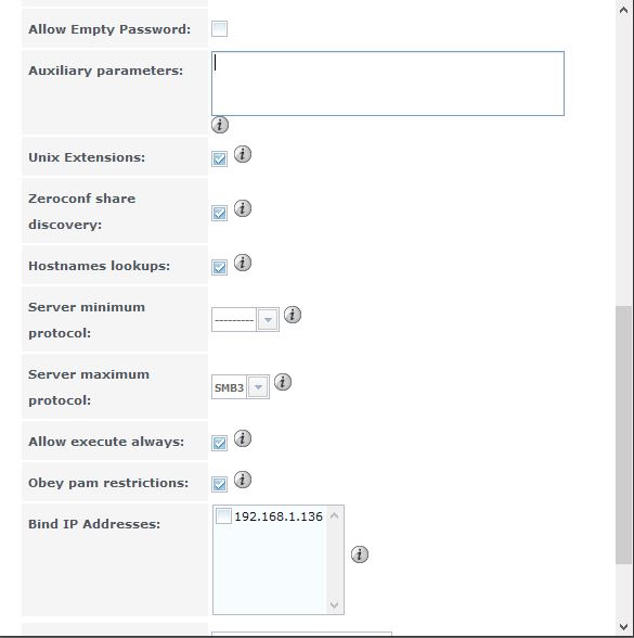

i have been running FreeNAS with my Apple TV 2 and 4 since FreeNAS 9.3… i am currently on FreeNAS-9.10.2-U6 (561f0d7a1) and all works well. I had no issue what so ever with my Apple TV 2s, but i did have to hammer my NAS with my infuse discovery on my Apple TV 4. at one point i had to crash infuse… go back in and then discover my NAS again… it did work after that. let me get some screen shots of my SMB setting and i will post them here for reference.
ok… here you go… the file names are named for how you drill down into the setting on the left hand pane… example… sharing_windows_smb_shares_1.jpg
click the plus on sharing… go down to Windows (SMB) Shares for the settings window.
Please that there are some permission settings that look somewhat odd… although the recommended file mask setting is 0666, i needed to set it to 0660.it corrected some issues for me and does not impact my ability to use FreeNAS from other boxes.
oh… stop and restart your SMB service once you make your desired changes.

After a few busy months, I had some time to look into this a little more. It appears if I drop the SMB minimum protocol back to ---- option in freenas, infuse will add the SMB share no worries.
When I reapply the restriction to use at minimum SMB2, infuse is no longer happy to play the game.
