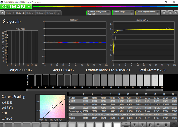

Made measurements on my ATV 4K with final release 11.3 and to me it seems that ycbcr is broken, grayscale is all wrong. I get correct readings only with RGB High.

I’m talking about YCbCr which is not working in ATV since 11.3
Check the screenshots.
1 - Ted Calibration Disk and also Amazon Firestick same readings.
2 - ATV + Mobile Forge - RGB HIGH
3 - ATV + Mobile Forge - YCBCR
Also CMS is 4 dE off. My B7 has 1.3 dE by deafult in CMS.
Did a ATV factory reset and changed HDMI input with no differences.
