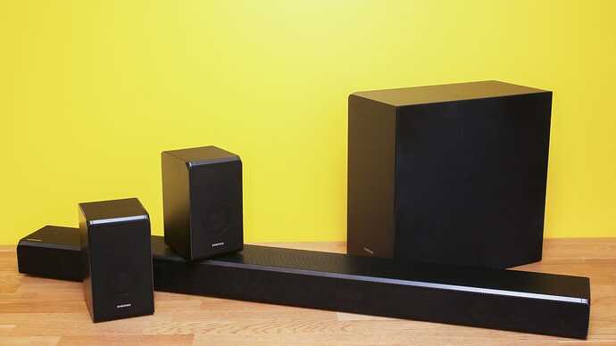

This is a disease lol. We may be in the same club shortly as I just snagged a deal on one of these:
Pester me in about a week and maybe I can reproduce the issue with my soundbar.
