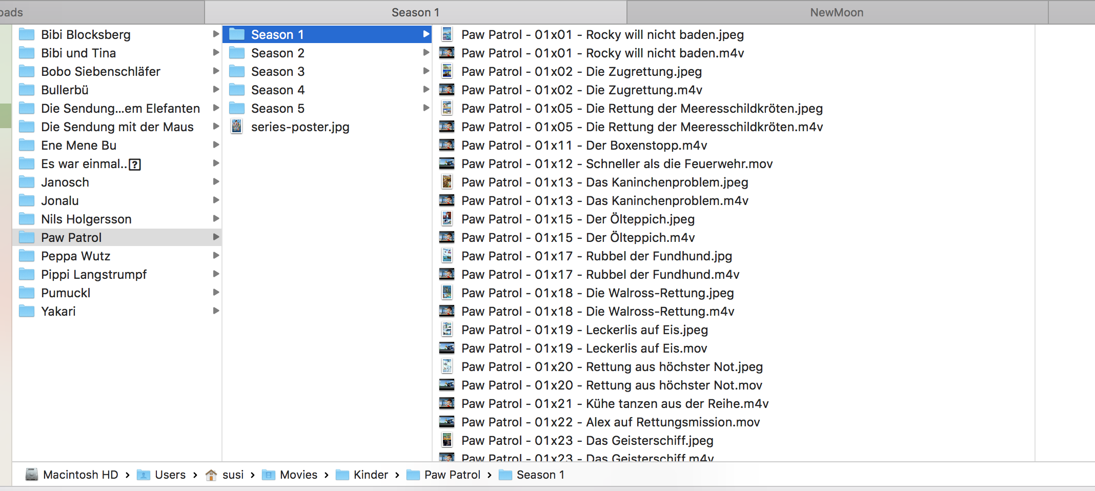

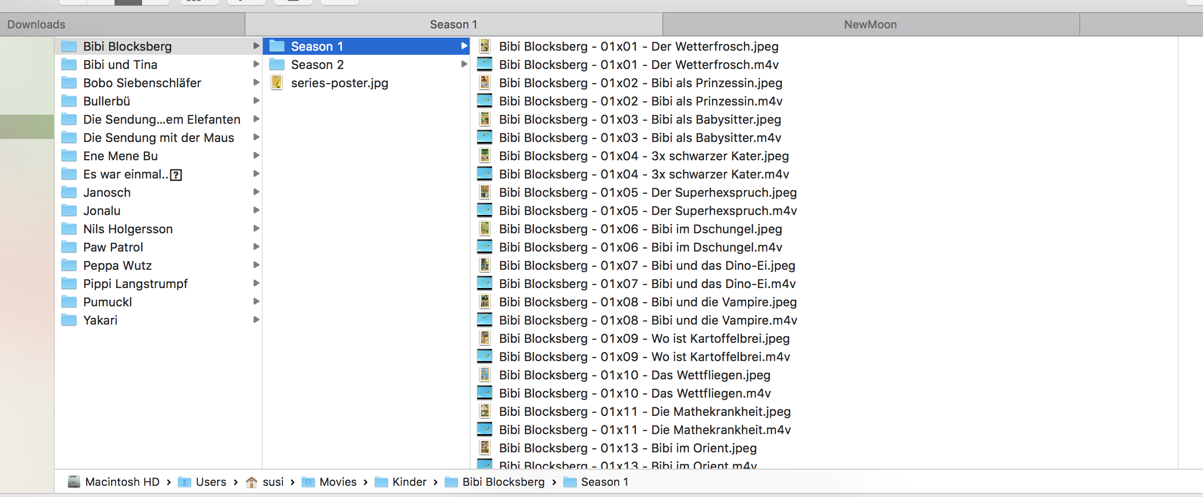

Hi eveyone,
I have some trouble getting tv show episodes showing the right episode posters. I have the posters as .jpg files with the exact same names in the same folders as the video files. I don’t think there’s a naming issue, because infuse pulls the right meta data from tvdb like episode description, year and so on. Also when I select the poster manually, it is shown correctly. I could choose the right poster for each episode manually, which would be fine for me BUT the posters disappear after a while again.
Turning off automatic metadata retrieval is not an option because then infuse doesn’t recognise the videos as tvshows any more, and the file view is a huge mess.
It’s so frustrating that it obviously works this way but is just buggy as hell. I took a (long) video of this weird behaviour so that you can see yourselves: https://youtu.be/SwOYUZxP66w
