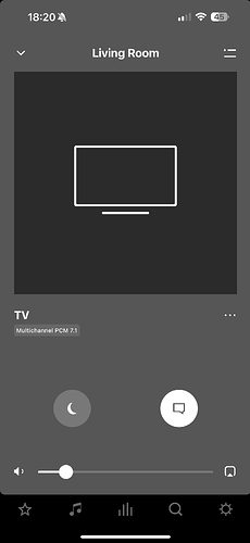

For that you should see ‘Multichannel PCM 7.1’ (like the screenshot I posted above).
