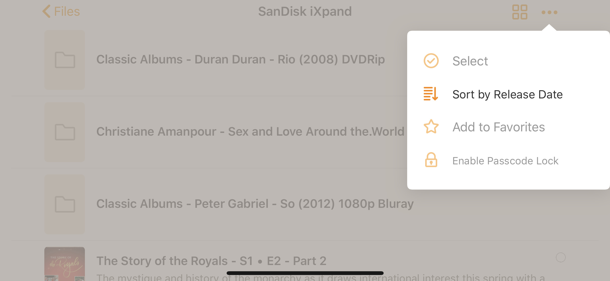

Just trying this and not seeing a download option after tapping on three dots…
When in library mode, as James mentioned you use the ‘…’ option on a movie/tv episode “ticket” to access the download option.
When in the file browser mode, you swipe left on a movie/tv episode to access the download option.
Your example is using the file browser mode.
