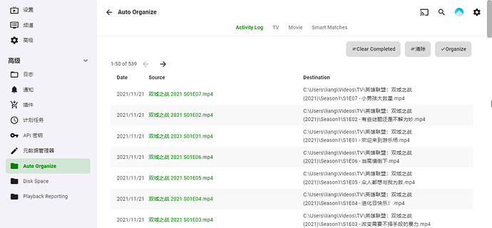

Simply use batch rename tool, rename them into Keyword+year+S#E#
Then put them all into auto-organize folder.
the plugin will do the job automatically.
