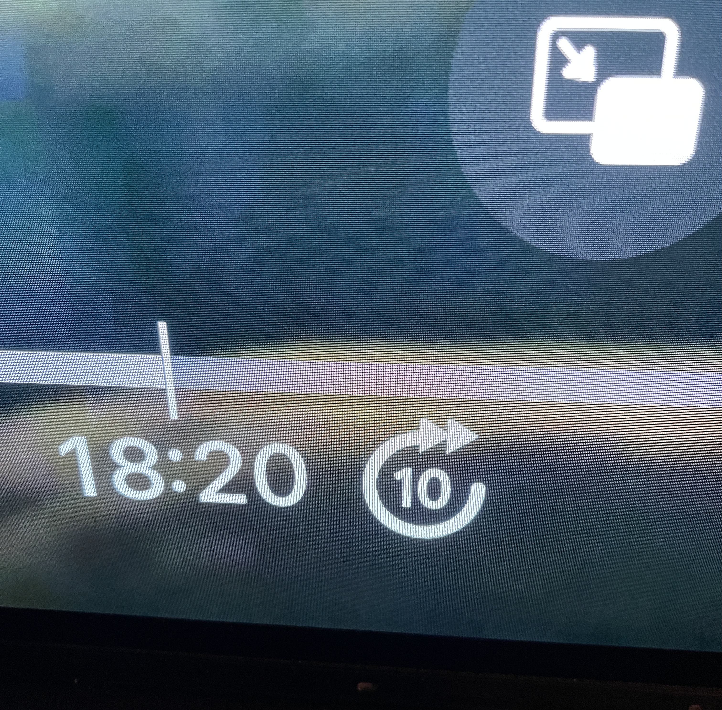

current infuse version 7.0.2, clicking on the (outer) ring left or right only displays a message “<10 Sec” or “>10 Sec” but does not skip forward. You have to press the middle button to pause the video and swipe left or right to scroll through the video

In order to skip 10 seconds backward or forward, I need to keep my finger on the left or right of the wheel for about 1 second, until the 10 seconds icon appears.

I can confirm what @Roda said that skipping 10s works only if you rest your finger for a second on the left/right side button of the wheel (until the skip-symbol appears) and then press the button. But you can get the 10s skip to work properly (such that there’s no need to rest the finger on the button) by going to Apple TV Settings > Remotes and Devices > Clickpad, and set it to Click Only. The problem with this is that then you can’t swipe though.
I also confirm that on 7.0.3 in order to skip 10 seconds backward or forward, you need to keep a finger on the left or right of the wheel for about 1 second, until the 10 seconds icon appears. It is not convenient at all especially if you try to backward 1 min :slight_smile: Would be great to have 10 sec. backward/forward just by clicking the outer ring left/right buttons like it is done in other players/streaming apps.
Is that how it is done on the Apple TV app? Apple hasn’t updated their human interface guidelines yet for the new remote.
Yes, that’s how the 2021 Siri Remote works when watching Apple TV+ shows in the Apple TV app - pressing a left/right wheel button immediately skips 10s back/forward. You only need to rest your finger on the wheel ring if you want to scrub by rotating your finger around the wheel (although I don’t think that’s any more accurate a method than the regular left/right swipe).
