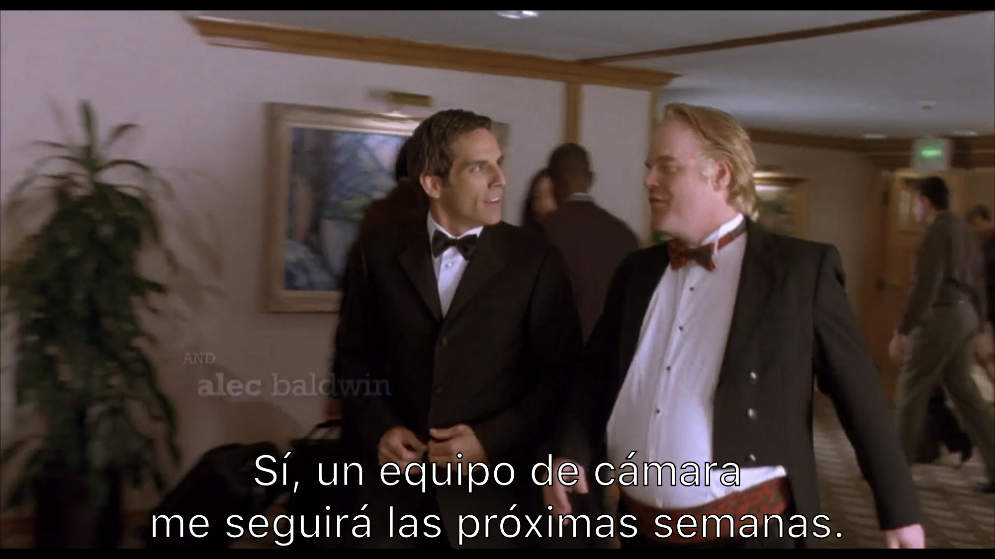

Subtitles transparent background
There’s any way to put a transparent background on subtitles?

Go to iphone settings-general-accessibility-subtitles&captioning then Create New Style and adjust transparency.
I did it but isn’t working on infuse ?
Infuse uses its own subtitle formatting, I don’t know why. But if you search the forums you’ll see that this issue has been mentioned a few times.
The lack of background can make the subtitles hard to read.
Thanks ??
Yes. It has do be done in the Apple TV Settings app
Settings App > General > Accessibility > Style
You’ll notice the three presets all have opaque backgrounds, so you have to create a new style.
Edit Style > New Style
I’ve spent way too much time fiddling with this because I can’t seem to find a setup that satisfies me. The one I have now is the closest I’ve come.
Text
Font: Helvetica
Color: White (Yellow is also a good choice)
Background
Color: Any Color
Opacity: 0%
Advanced
Text Opacity: Opaque
Text Edge Style: Drop Shadow
Text Highlight: Any Color, Opacity 0%
