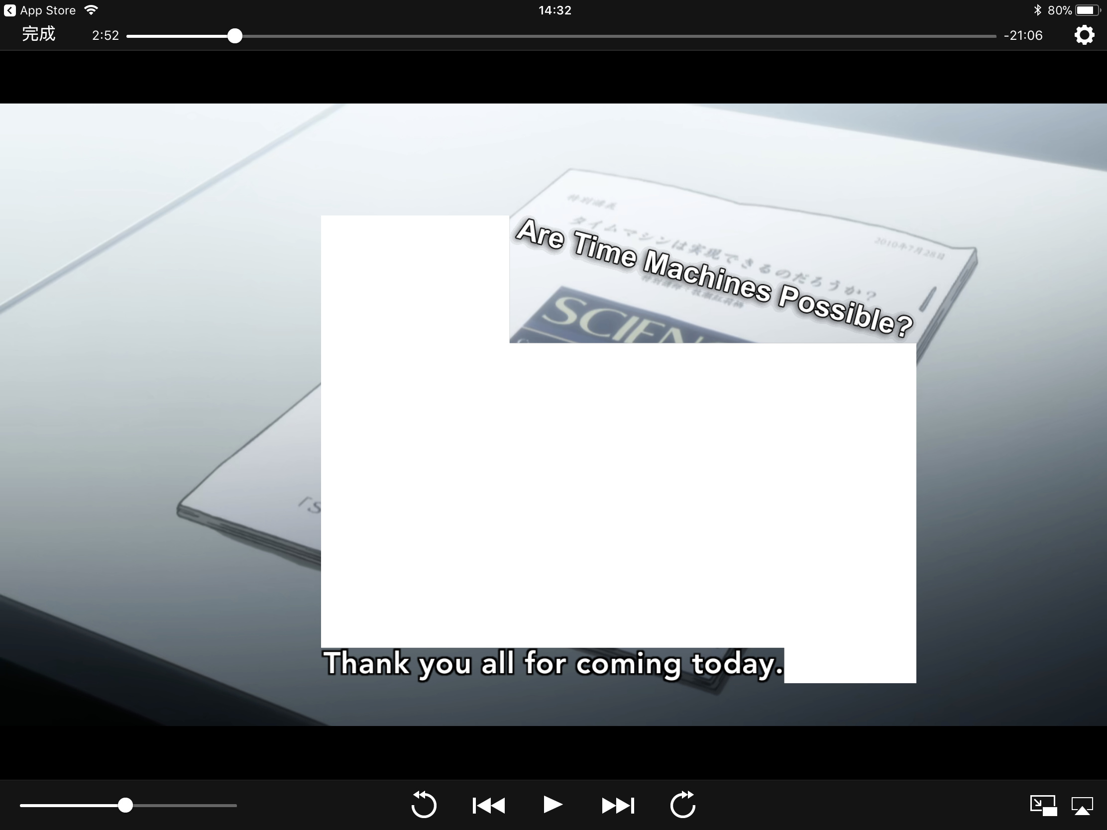

I’m running into issues with subtitles on Infuse 5.6 (issue also present in 5.5). It appears if there are slanted text in the current subtitle frame, white boxes fill the screen. Please see attached screenshot. This behaviour exists in Infuse 5.6 for both iOS and Apple TV. I am using iPad Pro 10.5 and Apple TV 4K.

Since I’m uploading a sample clip, I will go ahead and describe another issue I’m seeing. In MKVToolNix, I confirmed that the Japanese audio track and its associated subtitle track (Track 3) have the Default flag, however in Infuse, it always plays the English audio track and its associated subtitle track (Track 4) instead, neither of which has the Default flag. I have the language settings set to Auto in Infuse and in Apple TV.
To summarize, bugs exhibited in this clip:
  1. white boxes blocking the screen when there is a diagonal subtitle displaying alongside a normal subtitle (there are 2 subtitle tracks to prove this out, 1 with just the diagonal subtitle [Track 4] and 1 with both the diagonal and a normal subtitle underneath [Track 3])
  2. the audio and subtitle tracks with Default flag set are not being played by Infuse by default (the Japanese track and the problematic subtitle track [Track 3] are marked as Default but Infuse chooses to play the English track and the associated subtitle track [Track 4] without the white box artifacts instead)

Thanks for the sample. We’ll take a look at this.

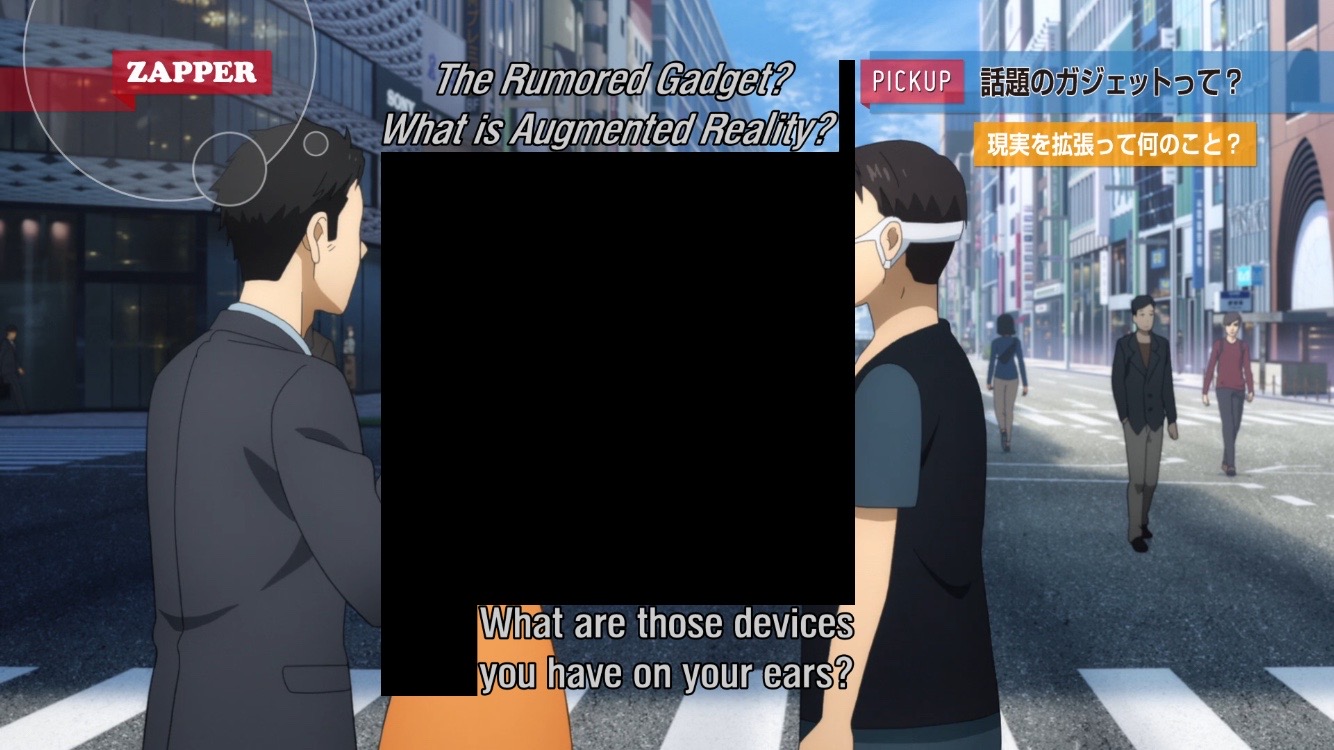

I see a similar issue with PGS subtitles. When there subtitles at the top (or middle) of the screen and at the bottom of the screen, the area between them are filled with black boxes. Same issue with Infuse 5.6 on iOS and tvOS.
Thanks for the note. We’re looking into this issue and hope to have a fix soon.
Update: This issue has been fixed for the upcoming 5.6.2 version. :slight_smile:
