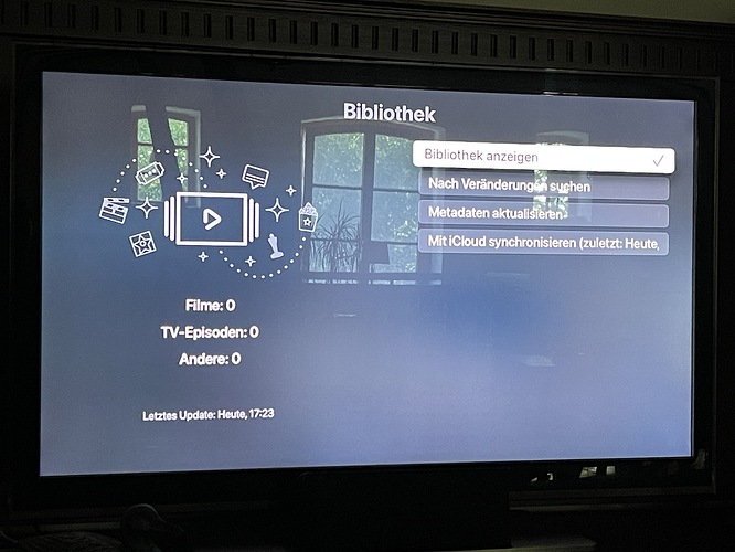

Ok, I’ve checked again the instructions carefully and obviously something is not working correctly at my end. I set up a share, I mark the folder where all my movies are stored in as favourite and see it on the start screen. But in the library settings, this folder doesn’t show up opposite to the instructions. Obviously, the reason I don’t see any genres is because the library was and is empty. What am I doing wrong here?
On the Apple TV, click on the gear in the upper right of the home screen.
Under Network, click on Library.
Post a screen cap of that screen please. :+1:
All empty, no folder to choose from.

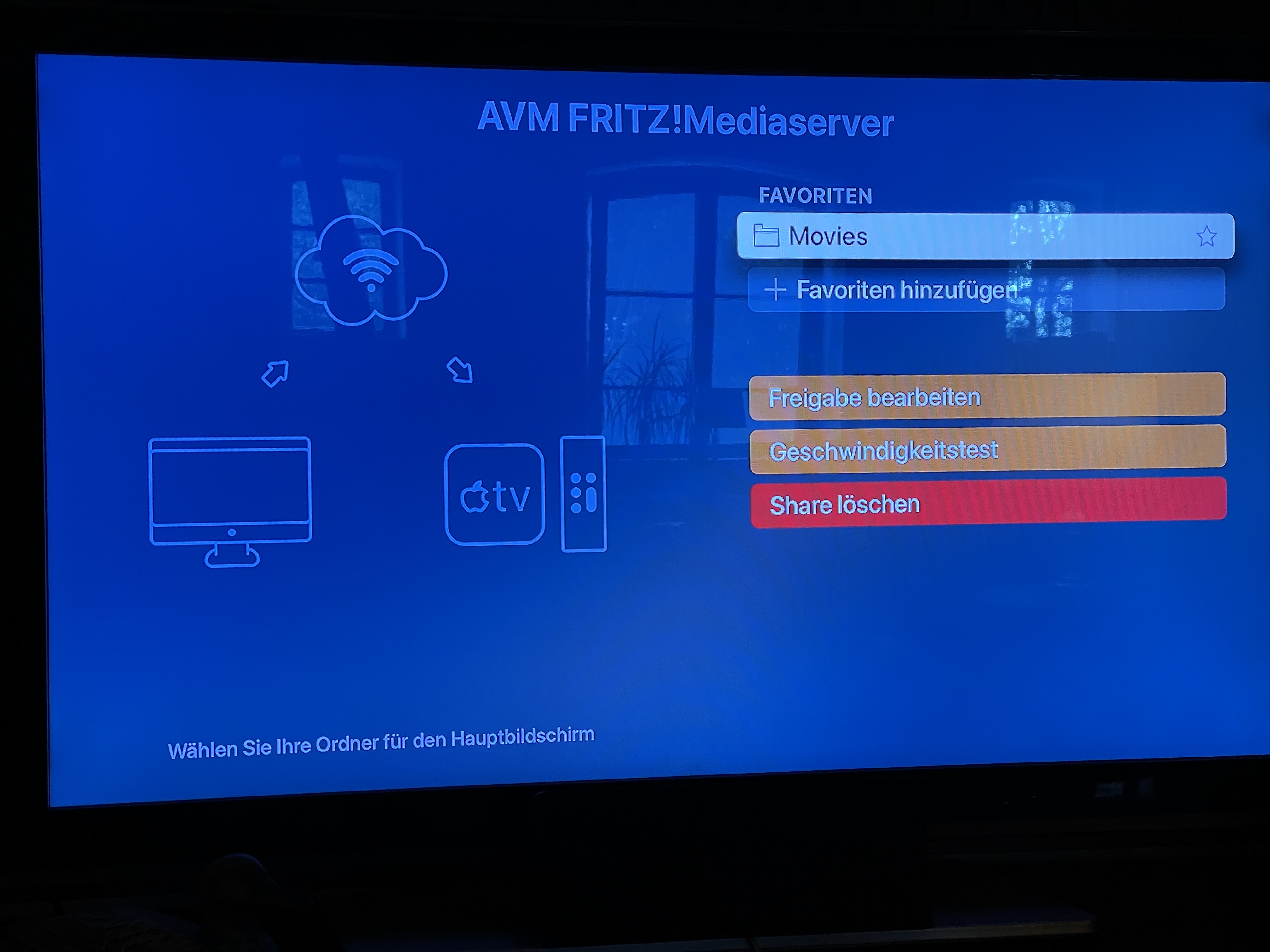

Okay, let’s look at another screen.
Under Network, click on Shares.

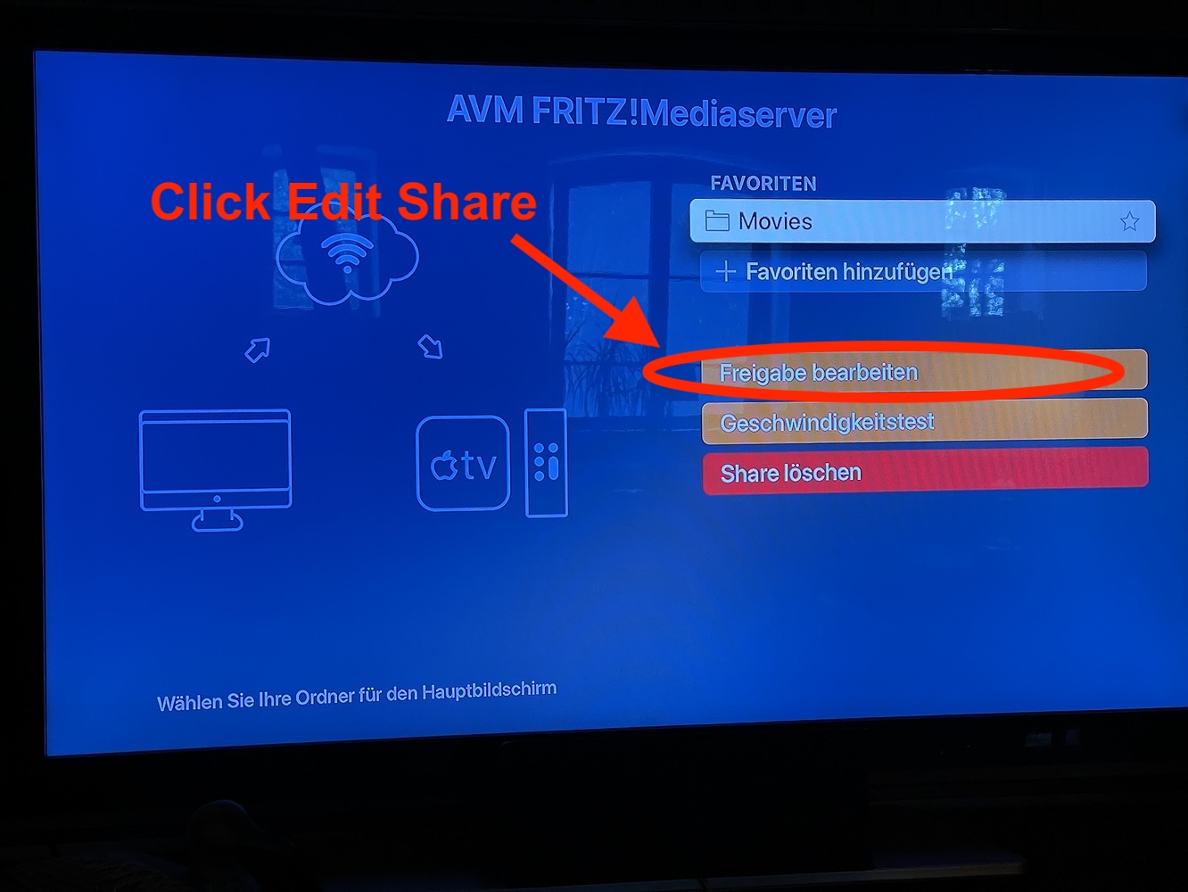

Then do a screen cap of the edit share screen.
I was wrong yesterday, it is not SMB obviously
That’s the problem. With UPnP/ DLNA you don’t get the library functions.
If you delete that share and start over adding the new one as SMB then you should have better luck. :wink:
