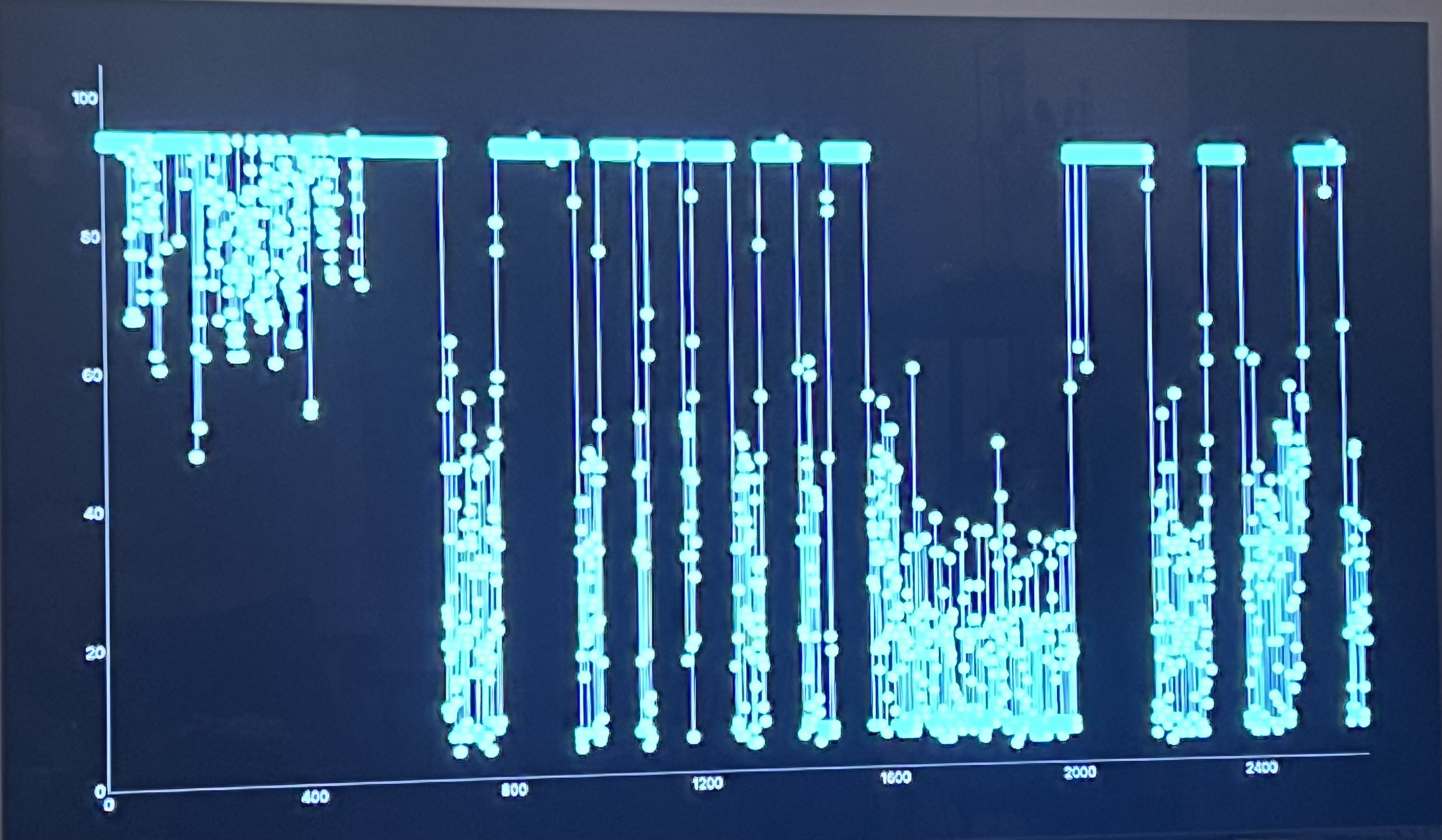

The video was around 3hr and test was taking forever to progress so I stopped it at 3%, here’s the graph:
I’ve found out that the video is 65,3 Mbps - so when speed test goes under it it’d cause loading. Now I wonder what’s the reason for this.
I suspect a bad network connection. Try again using either a wired connection or closer to the access point and see how the speed test performs then.
It would be helpful to run the test a bit longer to see if there’s a pattern. Usually it doesn’t take the same time to run a full test as the movie run time, it’s usually quite a but quicker and a 20%+ may show some clues.
If you can, I’d run a Ethernet cable temporarily just to run a test and see if that makes a difference on the speed test.
Another test if your raspberry pi can do SMB would be to try a connection from Infuse via SMB 2 instead of Plex and see if maybe Plex is throttling things for some reason.

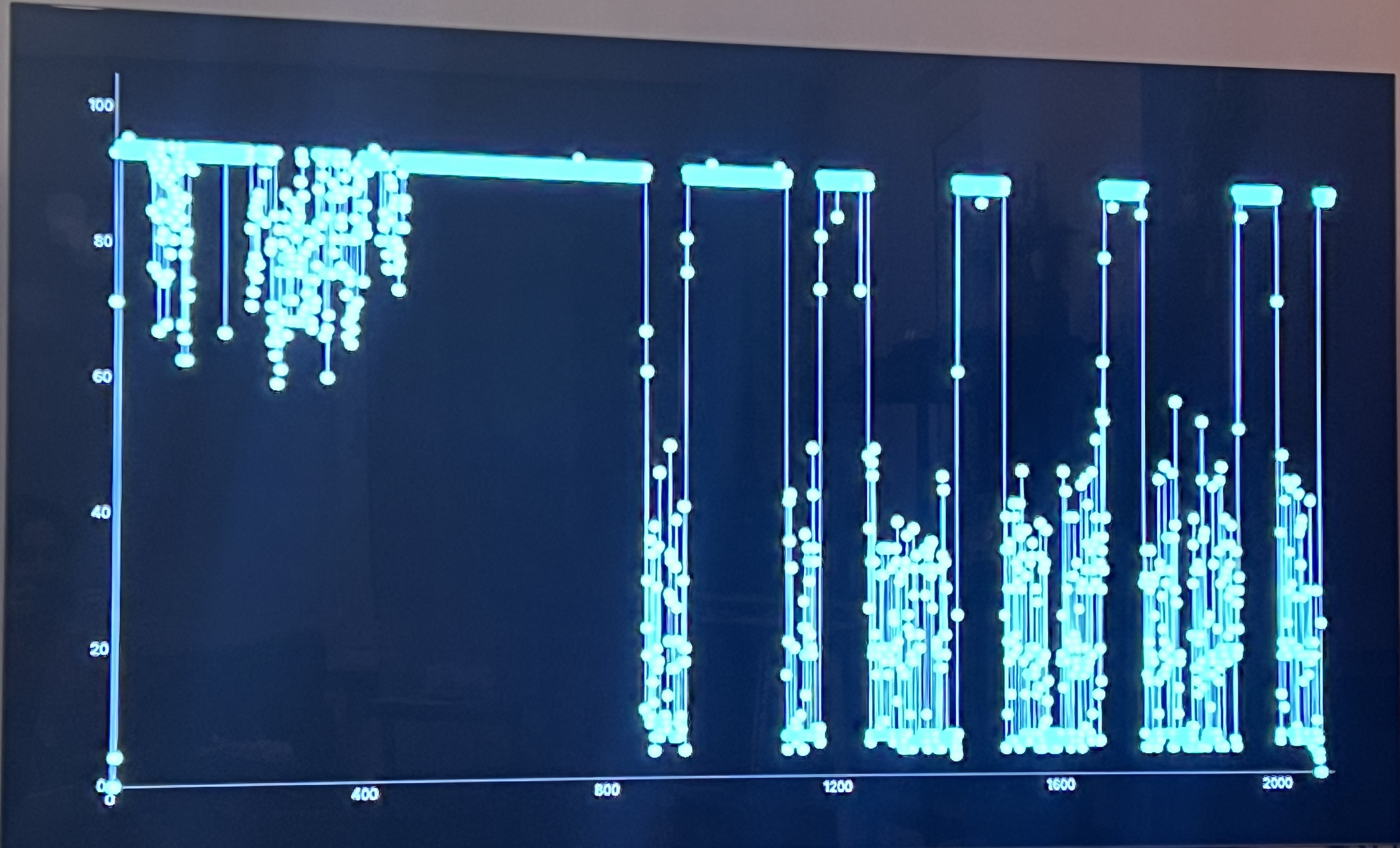

Here’s a test ran to 20% from Apple TV itself:
There is definitely an issue, most likely network. It could be the ethernet cable connected to your raspberry pi or it could be the hard drive itself.
This is the first and only video I had this problem, so it might not be a hardware issue. I’m considering a memory leak plex, perhaps?
Or it could be the file itself. If you run it again do you get the same results?
This would help eliminate the network.
This would help eliminate any protocol issues or Plex settings problems.
  1. Restart the router, Pi. and Apple TV.
  2. Run test again. If no change, connect Apple TV by Ethernet. Run test again.
This will,l if nothing else, rule out the most common and easiest to fix problems.
2nd test ran to 24%:

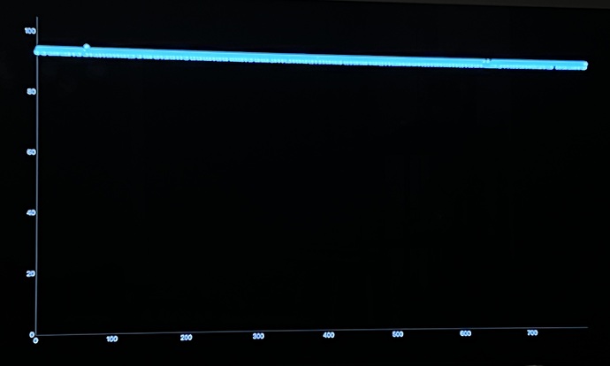

Here’s another file (23.76GB, ~3hr) speed test ran to %37:
Average speed was 94mbps.

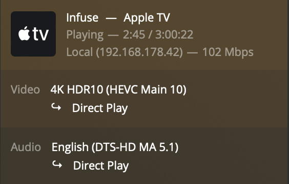

Here’s what I see on Plex dashboard while the video is playing on Apple TV app (without any loading):
ethtool eth0 | grep Speed gives Speed: 100Mb/s
The router (Fritzbox 7583) is configured to provide Gbit access to the LAN port but raspi is not using it. Possibly because of the ethernet cable?
Still nothing explains the speed drop happening when playing this file. Other file doesn’t have this, and network is fast enough to play this file if the speed didn’t drop. My curiosity only increases…
Yes that could be it. You definitely will want to have over 100 to support all 4K. File might be 65 average but peak can theoretically get to 128 or something like that.
