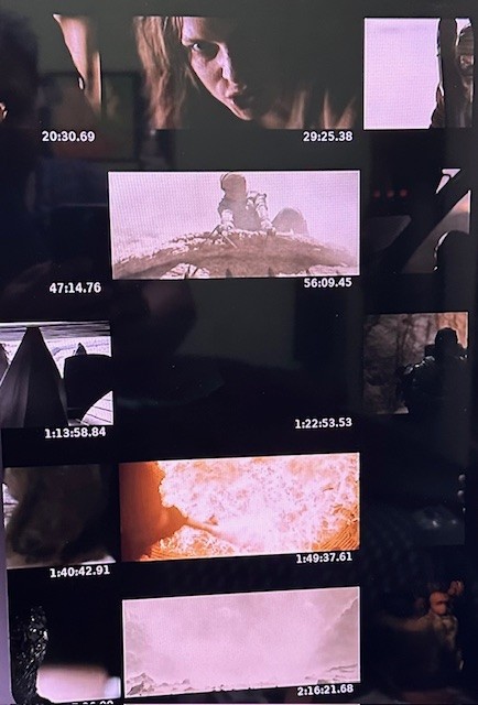

Mine is weirder then as all TV is fine its just movies - has Infuse recently changed where it gets the artwork (covers) for movies as they are not getting picked up just a preview of the movie is show (stills from different parts of the movie)

So I have those settings already - I havent changed the settings it was working before so not sure what changes I am making - two images show whats selected and what it shows - its like a preview of the video - is there a setting that I can switch off otherwise it is a bug then.
thumbnail_IMG_1721
what it shows instead of the artwork on the second screen

It doesn’t look like this artwork is being generated by Infuse.
If you have any of the options for Embedded Metadata enabled, Infuse would look for artwork embedded inside the file.
You may also check to see if there is artwork located near the actual video file, as Infuse can also use this - if present.

Are all of your movies now showing the same full page of timeline thumbnail screen caps?

All are showing thumbnail screen caps

I wasn’t able to locate any artwork on TMDB that looks like this, so I don’t think it’s coming from there.
This means the image is either embedded inside the video or a local image file stored near the actual video file.
You can check the folder where the video is stored to see if there are any images that look like this near it. I would also check the Embedded Metadata guide linked above to see if any of these options are enabled.
If you would like to upload a sample file you are seeing this issue with, I can take a look to see if it contains any embedded artwork.
Hi OP @deviantuk and @James – I am actually having exact same issue as OP and came looking for help (except I know that the same screen-caps thumbnail poster images ARE with the .mkv’s in the same folder, so I know where it’s getting them from). Here’s what I have done:

My situation remains like OP’s – if the movie had a thumbnail poster alongside of it, it’s pulled no matter what. If it doesn’t/didn’t, it pulls from online. How can I fix – besides going through and deleting the .jpgs from each folder? Why wouldn’t all the nuking above fix this?
Usually people don’t put pic files in the folder with movies unless they are wanting to use that instead of what is gathered from TMDB. About the only way is to remove the jpgs or maybe place them in a folder inside the movie folder so their not at the same directory level.

When you have a folder (or video file) set to “Local” it will not fetch metadata from TMDB and use metadata that is actually embedded into the video file if available. When it is not marked it will fetch metadata from TMDB and use that UNLESS there are metadata files like pics, xml, or nfo files in the folder with the video then it will use that to override the metadata from TMDB.
