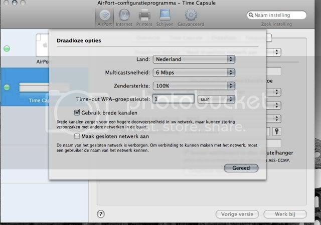

You can check wide channel in the wirreless options
sorry for my english
Thanks snowman, I did have wide channel selected already.
I appreciate the advice. :slight_smile:
K-the-ripper in SO FAR SO GOOD post said “Transfer speeds with cyberduck FTP are around 10 - 12 MB/sec. (much faster)”
I wish!!! That would be good enough for me but I can’t seem to speed up my Airport Extreme N protocol 5 ghz any further than app. 4 MB/sec (which is admitedly better than my original 1.2 MB/sec) whether it’s coming from my Imac 24 or my Macbook Pro…
Are you on cable or wirreless
Wirreless===>4.8 Mb/s cable===>12.4 Mb/s
