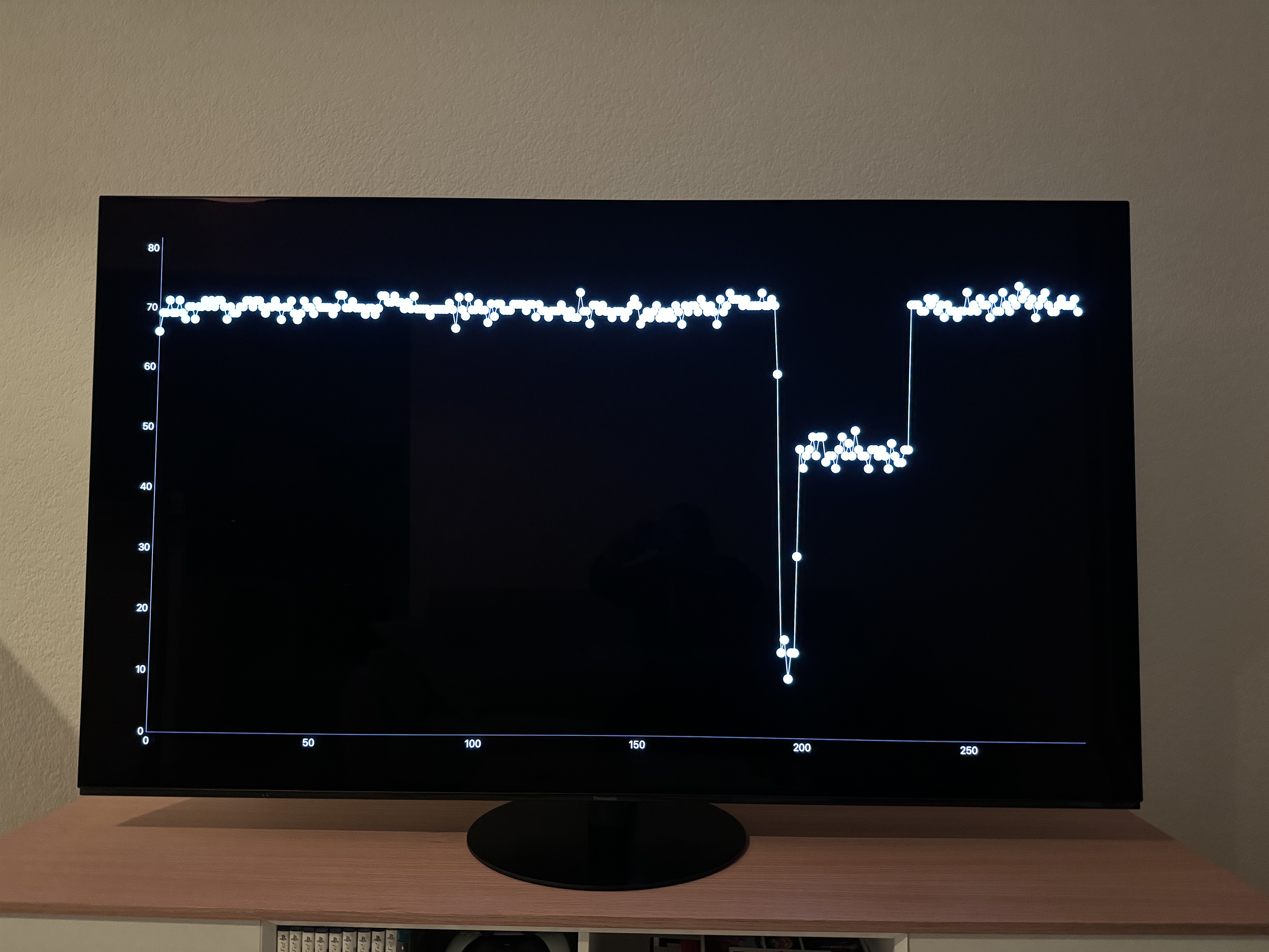

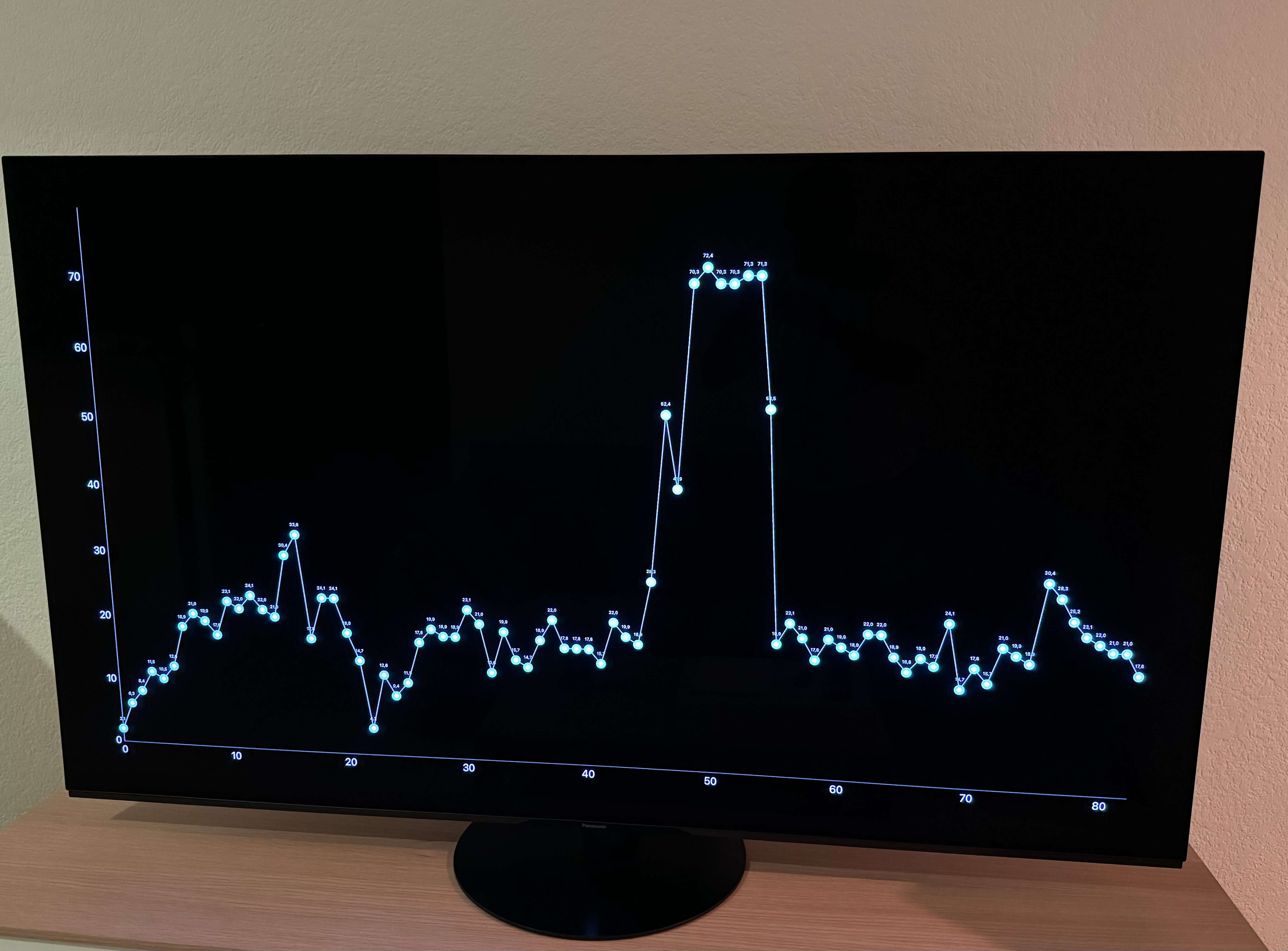

What does the graph look like in the Infuse speed test for this video? Run it to 100% to get the best indications.
Thanks for your reply. I couldn’t run it to 100%, would that help diagnose the issue?
You might need to download & zoom on the picture to see speed values.

I ran a longer test this morning and it looks better:
I noticed a drop, as you can see. Should I be worried?
