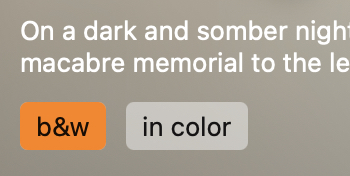

from my understanding, infuse sorts by resolution (highest to lowest) then alphanumeric (left to right). so your solution would work if they were all the same resolution but that’s the problem with custom tags, they have a mandatory resolution prefix so mixed versions can’t be sorted
but even if you do that, the perfect sorting isn’t always possible, for example, i want my color option to appear before b&w but that can’t happen alphabetically
Screenshot 2024-02-19 at 7.37.24 PM
Yep. Once you know to look for it, it’s clear that’s what’s happening. I was indeed getting misled because some of my special features (with ‘edition’ tags) are a different resolution than the main movies.
