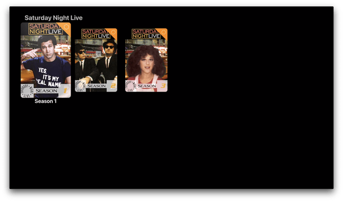

Edit to add: For The first the file names should be like
“Modern Marvels S01E01.mkv”
and for the second
“Saturday Night Live S01E01.mkv”
Edit 2

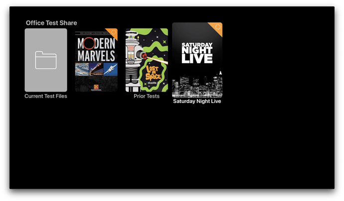

Also this is the file structure that works best for me so far.

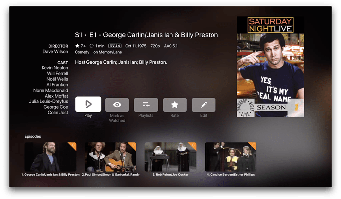

the only difference I see is it looks like you are file sharing from a macOS and i’m on windows 10. I know it works since the show American Restoration is working but still no luck with the others. here is a screen shot (i’d seen more but restricted to one due to being a new user):
I just manage things from a Mac, the files are on a Synology NAS using an SMB share.

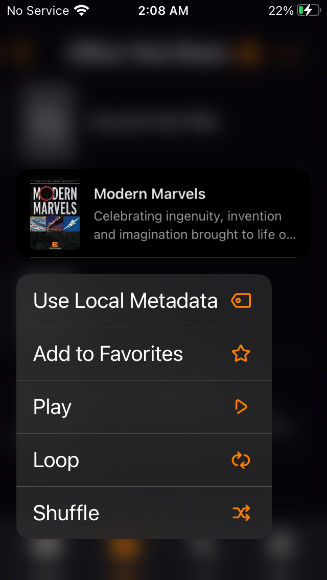

Do you by any chance have use local metadata selected for these two?
You can check following the users guide here.
If so you need to turn it off.
Also with the right names and file structure, have you done an “edit metadata” and reselect the correct show? That may reload everything.
Edit to add: I went back and changed mine to use local metadata on an iOS device and it looks like you may have Use Local Metadata selected, if you long press on the main show folder it will give you this screen.
If your top choice is “Use Online Metadata” instead of what mine shows (Use Local Metadata) that means you have Local Metadata selected and Infuse won’t fetch online info. Tap the Use Online Metadata.
