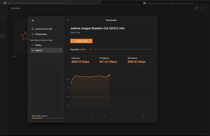

Im using FTP without TLS and getting near 900 MBps on AXE 16000
