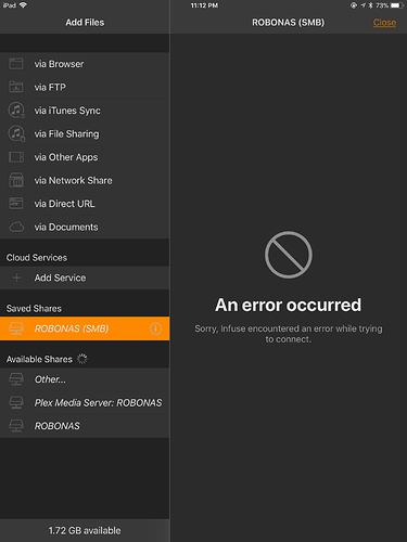

Phew glad I’m not the only one. I’ve been ripping my hair out trying to troubleshoot this problem. I opened a ticket# 99576
I have a Synology (DS716+ running DS 6.1.4 update 3) with SMB shares.
My iPad and AppleTV4’s Infuse is updated to v5.6.5 but refuses to connect to
a known working SMB share on my Synology still does not work.
Synology DSM 6.1.4 update 3
iOS 11.2.1
Infuse v5.6.5
Here’s what I’ve tried.
  • Confirmed my iPad is running Infuse v5.6.5 (1906) and all my devices are on
    the same network.
  • I reset the password for the User on my Synology.
  • Removed the non-working SMB connection in Infuse.
  • In Infuse I added Service (other because selecting choosing SMB auto fills
    the Address field as “servername.local” and won’t allow me to change it.
    Choosing Other defaults to SMB but allows me to manually enter the IP address
    of my Synology Server.
Results.
• I still get an error occurred when Infuse tries to connect. I can connect
to my Synology share perfectly fine from my MacbookPro (macOS 10.13.2)
• Infuse clearly “sees” my Synology as it shows up under available shares.
• One other oddity is I am also running Plex on my Synology. Infuse also
sees the Plex server in Available Shares, however when I connect to Plex and
browse any folders they all show up as empty in Infuse. They are not empty
folders.
