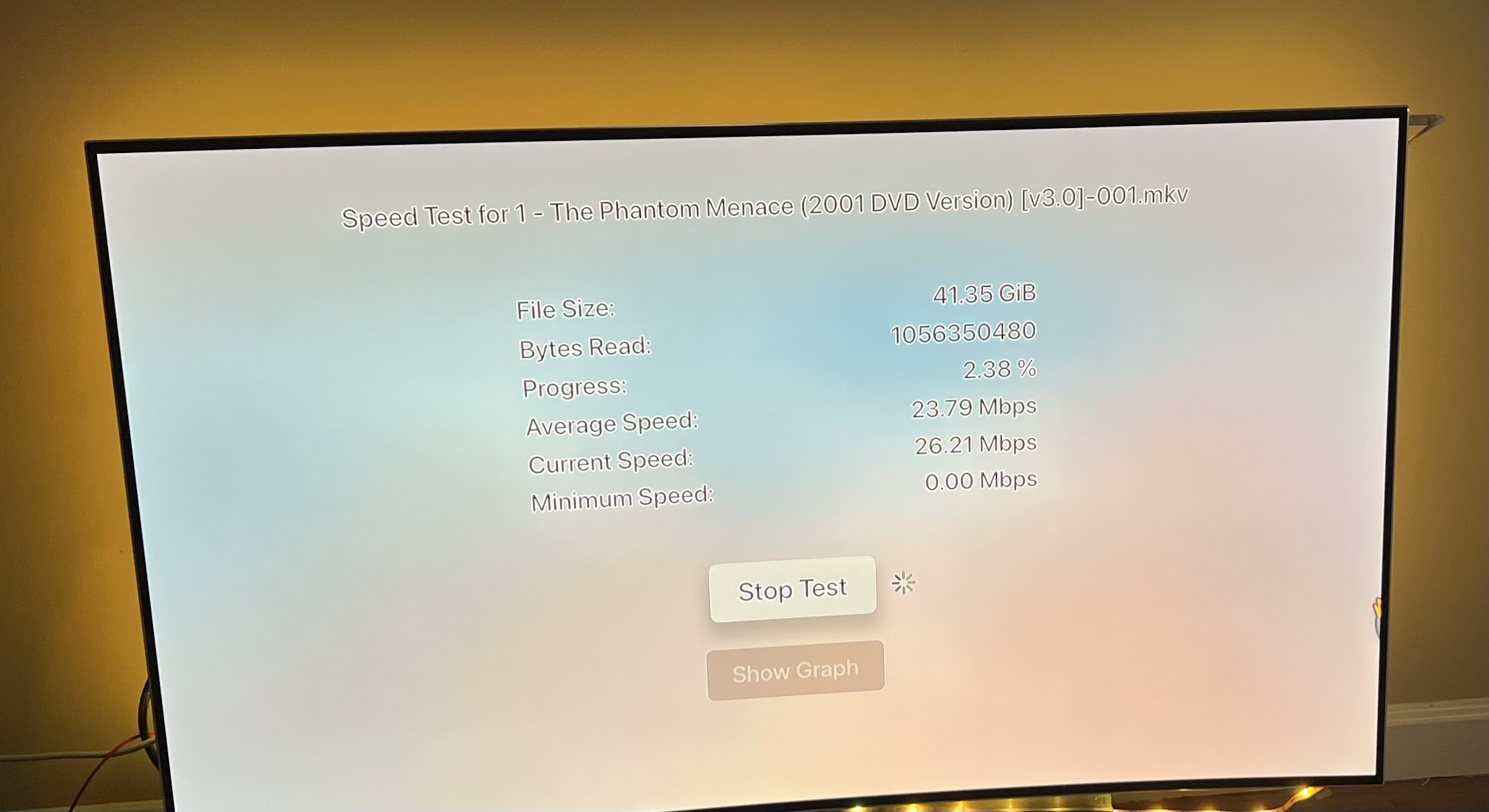

Ok so here’s the speed test, currently been about 5-8 minutes and it’s at 4 % which is what I meant by taking a long time and to clearfy your second question as you can see there are 3 speed readings
Average Speed
Current Speed
Minimum Speed
Though it looks like they won’t be accurate until the speed test is over, so it’s irrelevant, im performaning it on the 4K Apple TV with the latest update on both
How are you connecting the ATV to the LAN? Ethernet or WiFi? Those speeds look like either poor WiFi speeds or one of the lower speed Ethernet protocols.
What does the graph look like for the test you ran?
Ethernet would be 10mbps or 100mbps if we’re talking about the old Base 10 and 100, with his test coming out at 20 something mbps even USB 2.0 is quicker than that.
Gotto be Wi-Fi surely OR a remote server with a slow upload speed.
Not necessarily. That’s why I asked. We’ve seen several cases of old Ethernet switch rated 10BT and some cases where the cables were faulty or just old. That’s the reason I asked about it first then will work on it once we’ve narrowed down the possibilities.

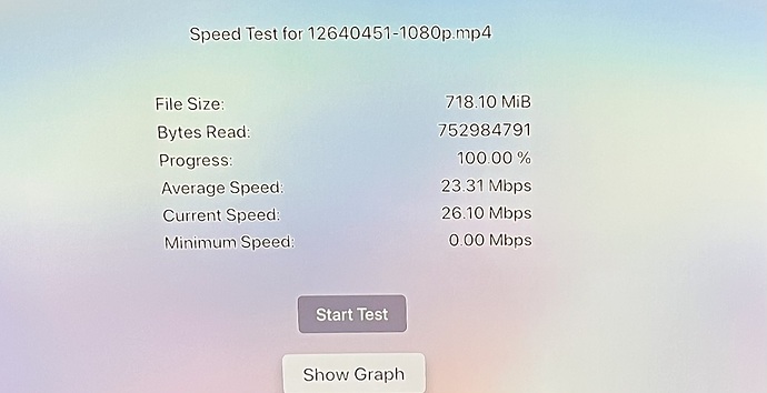

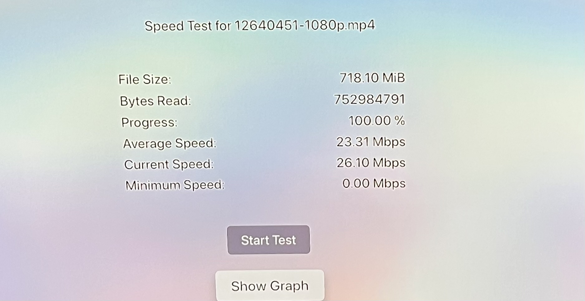

Ok so bad news is the big video file stopped because the tv turned off, the ok news is I tried the test on a file that never gives me problems and like you said it probably took me like 3 minutes for it to complete, so that’s good. Here are the results of the good file
First, I didn’t realize you were streaming from mega so the internet lags also come into play.
You shouldn’t see the down spikes to zero when streaming it’s no wonder you’re seeing problems at times.
