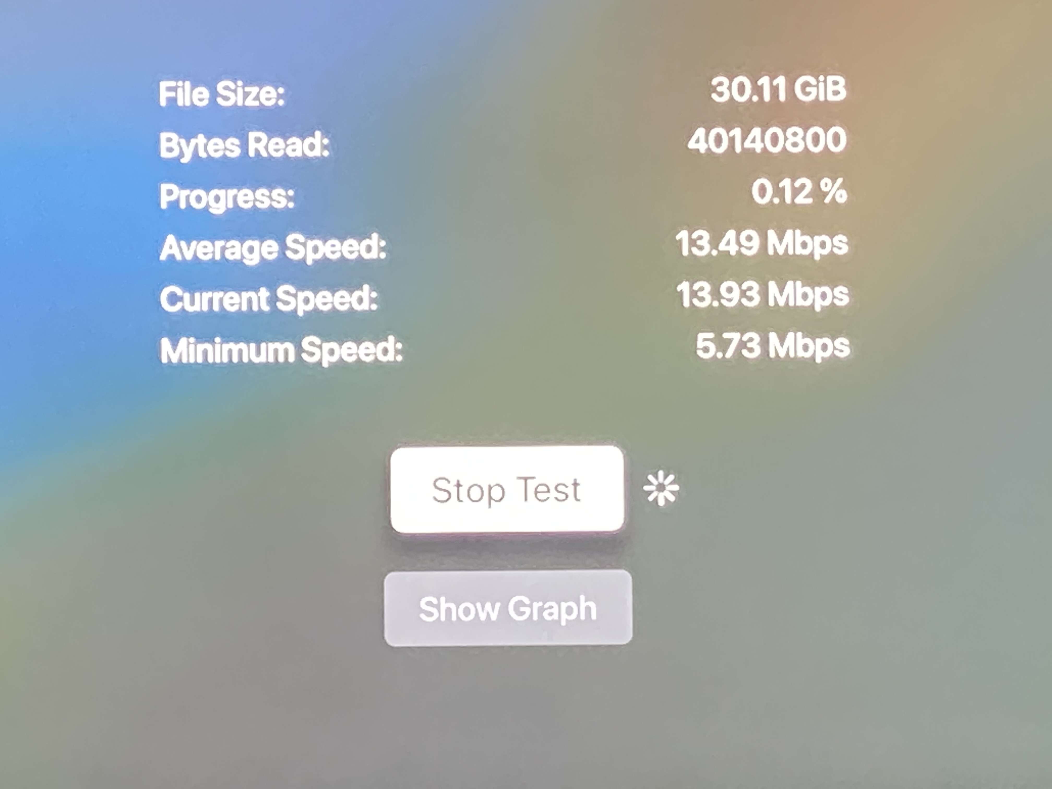

I have set up a Plex server on a remote location with 1Gbps Full-Duplex Wired Network and I am streaming on my ATV 4K problem I am facing is that I can’t get more than 15 Mbps speed and due to this my movies constantly buffer. I am using a wired connection on my ATV 4K my internet speed is 200 Mbps Full duplex but I can’t achieve more than 15 Mbps speed test result via infuse.

Yes I have tested and the same issue on Plex and now I have switched to FTP and the problem is the same it’s providing a Maximum 15Mbps speed Idk where it’s throttling .
tried that too but still it’s same and now i am on FTP via remote server and problem is still same 15Mbps maximum speed i can get what could be possible troubleshoots from here? i am streaming 4K HDR 30 GB.
